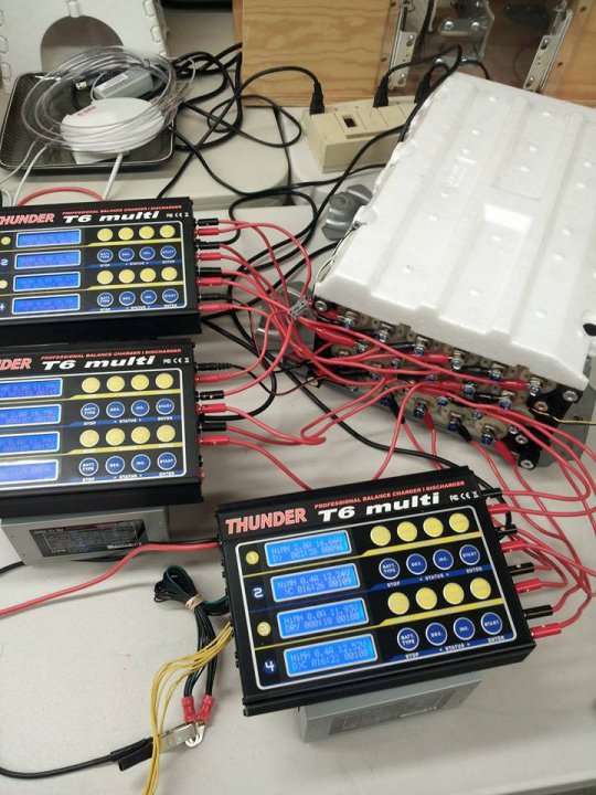

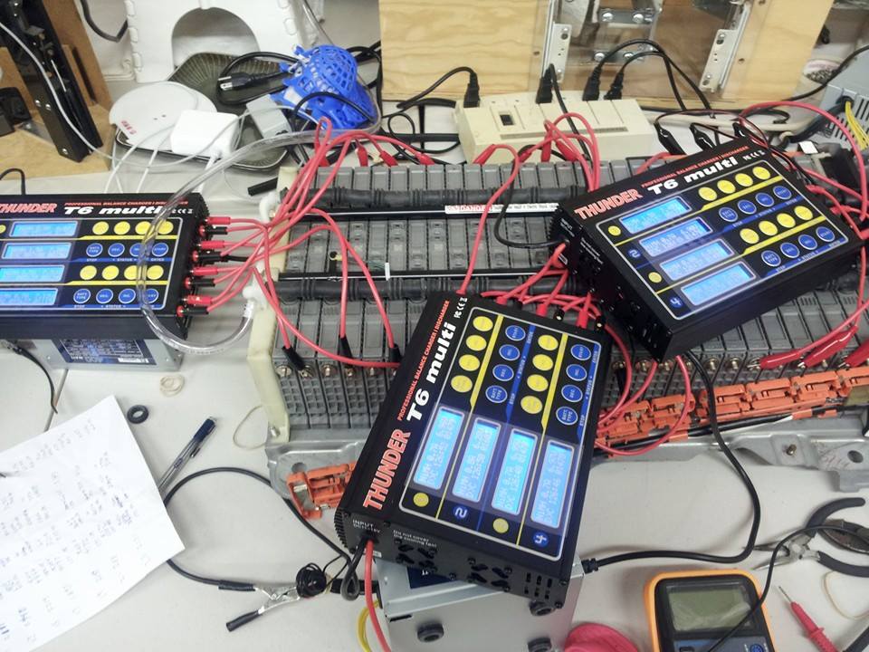

    I am not really interested in selling since I have 4 hybrids in the family to support. It has already saved us near $6000 instead of paying dealer battery installs. Also, since I only replaced bad modules, it is more likely to have problems in the next year or 2. I want to keep the chargers for when I have to replace other modules going bad. Mine being a 2005 w 294K miles.
    My setup I got from lamtech. It is 3 Thunder T6 chargers with 3 400watt PC power supplies. also had all wiring to charge discharge 12 modules at at time. In addition, enough wiring to connected all 28 modules in parallel.
    Minimally, I would recommend you get at least 2 T6 chargers or equivalent from Hitec. Most of these chargers are clones of one another. Just get the cheapest source you can find. The cheapest I have seen is about $110+10 shipping for a 4 channel charger. I assume you have a 12V battery and 12V battery charger at home. You can use this setup to supply power to the T6 charger balancers. This would cost you around $120 times 2 and cost to create the wiring. Should be way under $300 for the setup. This was the setup I was going to make until I saw lamtech selling his set. Not having to cut wiring just saved me time. Let me know if you need specific pictures. I have upload the ones on my phone. If I was making the wires myself, I would have used black wires for the negative to make it more clear than just having black ends.

    Thanks, for the info and photos. Would the Grid charger, balance the battery out and do the same as the chargers you listed?The Grid charger I'm talikng about is the one listed on Priuschat under the shop tab.

    no, grid chargers are low amperage chargers with high voltage. The setup I have is for charging and discharging the modules individually. Grid chargers are meant to be use while the battery is still in the car. Basically balancing them by overcharging the whole pack(in series) at a slow rate. 2 different concepts you need to understand before just buying things.

    You can use a battery charger balancer (grid charger) for preventive maintenance or rebuilding
    Much quicker to charge the entire pack at once and let it balance at the top rather than doing modules one at a time.
    Plug it in one time and let it go for a day. Done.
    It would be a tedious process to use small hobby chargers to do maintenance charging. I can't imagine a casual user opening up the hybrid battery and attaching 28 (or 38!) leads just to do a routine balance. But a casual user could easily attach the harness to the charger, and then plug the charger into the wall.
    Hobby chargers are interesting, and helpful to a point. But don't provide the ease of use most people want/need. (did you see all the wires from post #10 using hobby chargers?)

    I did see all the leads in post #10 and look like a real pain to try charge them separte, I couldn't understand why you couldn't just put the Battery back together and let the Grid/charger balancer charge it and balance the cells, but I was told this is two different concepts.
    So the grid/charger would be the easier way to do it?
