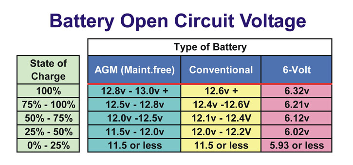

    Just for reference purposes and a gentle reminder 11.8 volts is rather low for a AGM battery. That is in the area of 40% of full capacity. As you said, a 12 volt replacement is in your future.
    It would be wise to replace it before you end up in a situation where you are stranded. It often happens on a cold rainy or snowy night when it is most inconvenient.
    Glad to hear that "rebooting" the 12 volt cleared the lights up for you.
