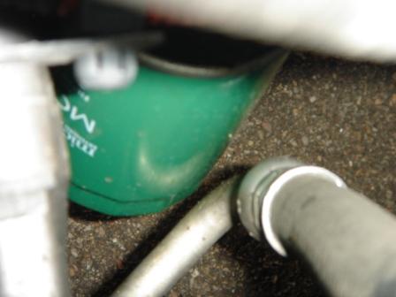

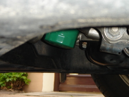

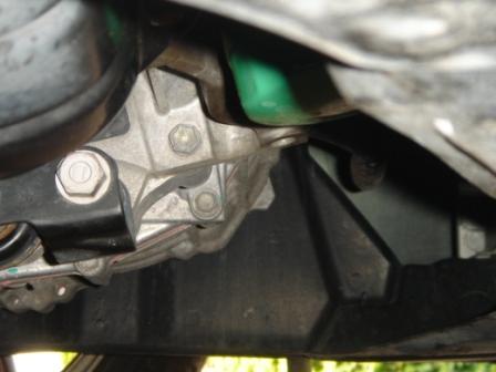

    I found this in another thread, and thought it would also be relevant here:
    Thank you Kohnen for your informative posts both here and elsewhere.
    I also had an MG 301-1 installed. It is indeed much larger than OEM.
    I took some pictures in case anyone is interested in how an oversize filter fits in the engine compartment:
    As seen from above
    As seen from the right wheel well
    As seen from the left wheel well
    One sees: plenty of room around the filter, and plenty of ground clearance for normal on-road driving.
