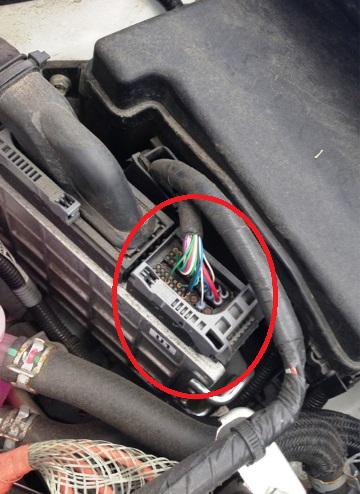

    It first stood out to me after I did the Inverter re-programming recall. I wondered if I hadn't seen it before or it had been removed during the recall and not replaced.
    Now I saw this picture in someone else's post and see the same exposed wires...
    http://img.photobucket.com/albums/v411/HAWAIIANBUILT/PRIUS%20III/000%20MODIFICATIONS/064%20ENGINE%20ROOM%20COVER%2011%2025%2012/IMG_6436.jpg

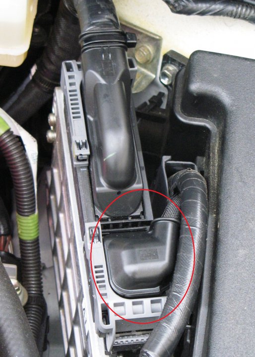

    This is on the driver side of the engine compartment with the rearward most connector being covered with a nice plastic sheath, but the forward one entirely exposing the wires and the backs of the weatherpac connections.
    Seems a bit odd. This is the same on everyone's?

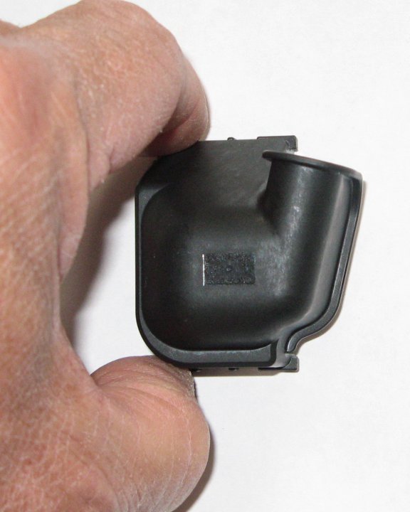

    Here's a few photos.
    Just make sure you get the one with the "removal tabs."

    Thanks for posting this info. Just got my new Prius a few weeks ago. Checked under the hood after reading this thread and noticed no cover also. I wonder why they aren't installing these at the factory if a cover exists?? Nonetheless, I ordered one tonight.
    It looks like all you need to do to install this cover is open the grey wire harness lock and pull up; put the cover in place, then re-seat the wire harness lock?

    Correct. It's that easy to install.
    Replacing or repairing that part o the wiring harness would be very expensive, should it be chewed by rodents.
    From what I hear from PriusChat members, rodent damage happens quite often with the Prius.

    I received the cover yesterday and tried to install it today. It appears the wire bundle from the harness is at a different angle than the opening on the cover. I tried to reposition the wire bundle to match the angle of the cover opening, but it looks like I am putting some strain on the wires and the connections. I am planning on cutting a corner out of the right side of the cover to let the wire bundle keep its current angle. The sheath that covers the wire bundle is long enough that itwould still run under the part of the cover I remove. Anyone else have this problem with their wire harness and cover?
  18. Mike500
    Mike500 Senior Member
    Mar 1, 2012
    2,593
    764
    Over time, the wire bundle should conform, and there will be no strain. The "set" occurred, because there was no cover installed during production.
    I wouldn't cut it.
  19. My590L
    My590L Junior Member
    Aug 27, 2014
    42
    NorCal, CA
    Thanks! After some gentle 'retraining' of the wire harness into the angle of the opening, I was able to install the cover. Just ordered another one for my wife's v!
