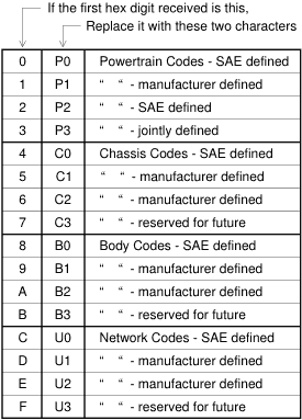

    That would be correct for the code P0301—that is, the SAE-standard P0 code that applies to any car with an engine and means a misfire in cylinder one.
    Your code is P3001—a code in the "jointly defined" P3 range, and in a gen 1 Prius, Toyota uses it to mean a malfunction in the hybrid battery ECU.
