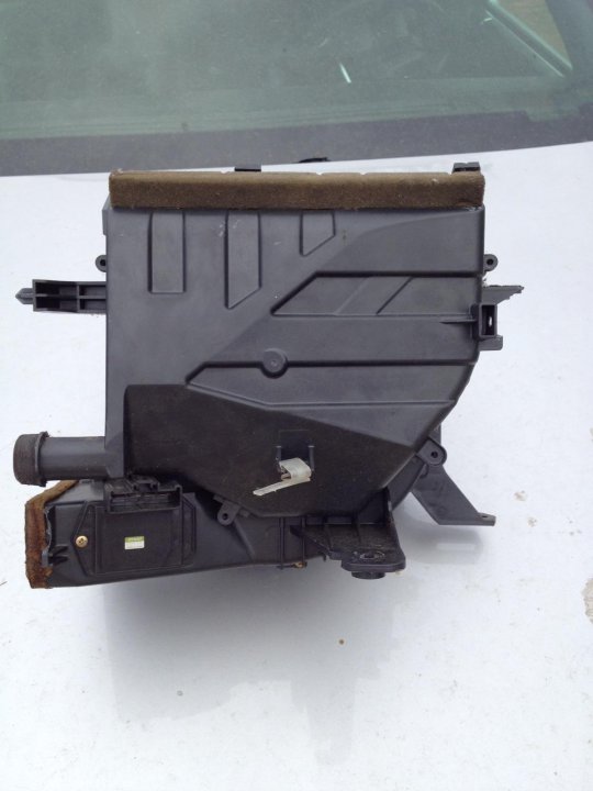

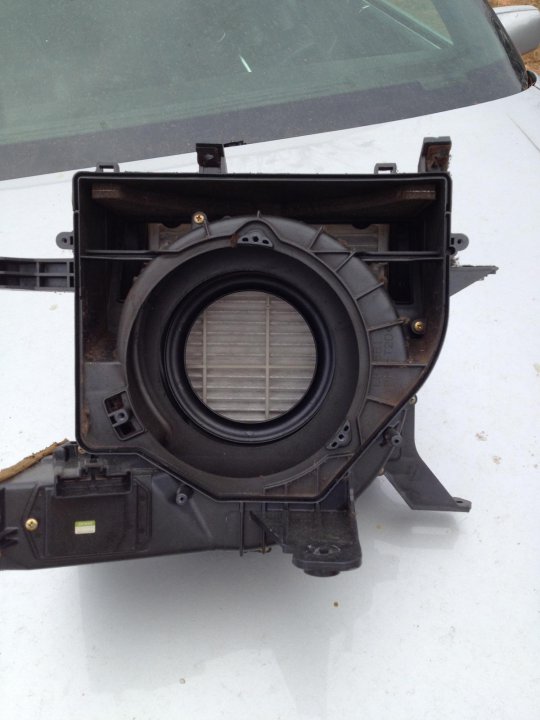

  15. hardish
    hardish Junior Member
    Dec 12, 2013
    2001 Prius
    Thanks for your patience and support. I am learning from experts like you and others in this forum. Great to have you are there for support.
    I am attaching picture of the a/c blower cover. Someone from an ebay store sent this picture to me which help me get to the blower. It may help someone else.
