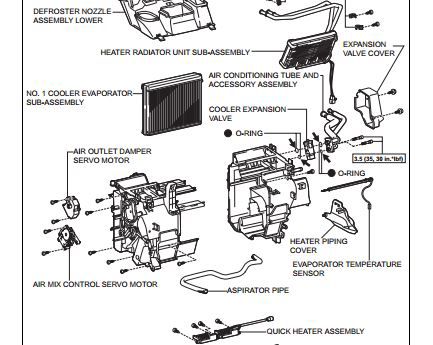

    Is this guy talking about the expansion valves when he mentions the orifice tube?
    Expo Prius likes this.
  12. Mike500
    Mike500 Senior Member
    Mar 1, 2012
    2,593
    767
    Originally, air conditioner used a thermostatic controlled expansion valve just like the large commercial units.
    In the late 1970's and early 1980's, many smaller units replaced the expansion valve with orifice tubes.
    Today, most auto air conditioners use orifice tubes.
    The effective function is nearly the same.
  13. creature0077
    creature0077 Junior Member
    Jun 26, 2009
    42
    Austin, Tx
    Are you saying the Prius has an orifice tube? If so, do you know the part number?

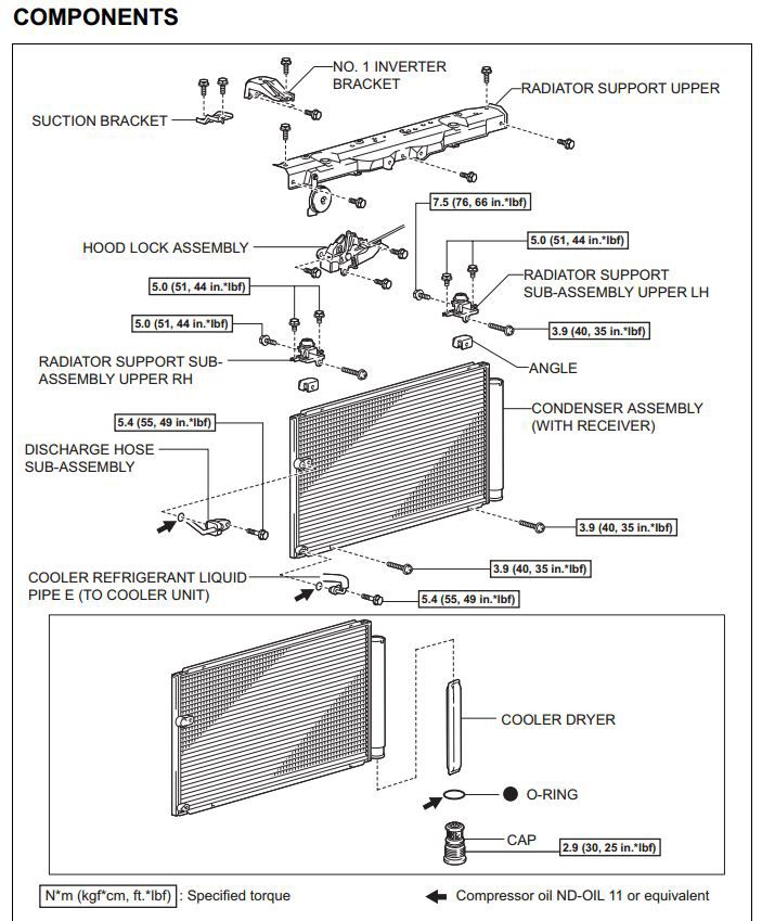

    There is no "orifice tube" per se, but closest thing is called a cap in the condenser. I think it performs a similar function to the orifice tube but you won't fit an "orifice tube" in the parts listing.
    The cap is located on the bottom of the condenser near the cylinder on the side. You should be able to screw it out and check to see if there are metal shavings in there. Also can check the drier too. Problem with opening this is that you will need to evacuate the system again since you are letting air and moister inside.
    The sight glass isn't supposed to have much movement, for proper functions it's actually supposed to have no bubble after it's already running.
    I replaced my compressor, condenser, and expansion valve 2 months ago and had it recharged and everything is working well so far. Did all the work except the recharge myself.

    The expansion valve was a b$#*&. You're required to replace it whenever you replace the compressor to keep the warranty of the compressor intact. I assume you don't have the shop manuals? The expansion valve is located in the interior of the car under the dash near the firewall. It took me several hours to get to it and pretty much ripping apart the whole dash.
  18. creature0077
    Jun 26, 2009
    42
    Austin, Tx
    Btw, it's located on the passenger's side behind the blower unit. I was able to get to it without removing the blower unit completely, but it wasn't easy. Still had to take off most of the dash. Now I forgot to connect something so there is a rattle somewhere in the dash, gotta rip it apart again to see what I forgot to fasten down.
