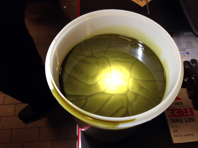

    Update; Prius and I visited the dealership on Friday. I drove two service Techs around the area where the dealership is located. The petrol motor did its usual thing, sounding more fluttery. Each could not specifically verbalize what they noticed but agreed the engine sounded odd.
    With the second Tech, we pulled into a service bay. He checked the dipstick... looked ok. He hoisted Prius and got out a stethoscope type device and went around poking and probing the motor but couldn't specifically locate an obvious sound.
    Then, at my request, he unplugged the oil pan. Then with a small container I supplied him (I wanted an oil sample to take with me for further inspection) he dispensed the first part of the motor oil into this container. While allowing the remainder of the oil pan to drain into his shop collection caddy, we relocated to a shop bench where he got out his Mag light and cast it upon the freshly tapped (and hot) oil.
    It was bright, sparkling (Metallic) Oil Green!
    The Service Manager had made his way back to the bay by this point and was able to view this along with the Tech and I. The tech mentioned right away... "Oil looks good, except... it's not supposed to be metallic!" So, as the "Smoking Gun" was revealed the Service Manager and I made our way back to his office where he transferred me to their loaner vehicle person.

    Here is the (first 5 Cups) Oil dispensed from the oil pan.

    I would love to see inside the oil filter I bet it is crammed with metal particles. The metal carrying oil would also have to pass through the oil pump on it's way to the filter. What a mess.

    A short engine block does not rectify likely damage to the valve gear and cam bearings running with no oil risks damaging all moving parts lubricated by the oil.

    Most certainly yes. The oil pump pumps unfiltered oil to the oil filter that you know was full of metal particles, and consists of steel rotors with fine dimensional tolerances"driven directly off the crankshaft" rotating in an aluminium housing. The result is scored rotors and housing with increased clearances.
    This means any metal particles passing through the pump will score both the rotors and the aluminium housing allowing oil to leak back through the pump reducing pressure and oil flow rates. The metal contaminated oil that you looked at would be clean compared with what the pump has drawn up and passed to the oil filter, and the oil filter has trapped "why I said I would liked to have seen inside the filter".
    As stated previously all moving parts within the engine require good lubrication with clean oil at all times. This means, crank and bearing, pistons,rings,and bores, camshaft, timing chain,and tensioner, variable valve timing mechanism, valve cam followers. In other words the complete engine. Nothing will have escaped the affects of either running without oil, and or running in metal contaminated oil.
    This should not affect the transmission apart from possibly discharging the HV battery if the car was driven to far when the engine stopped.
