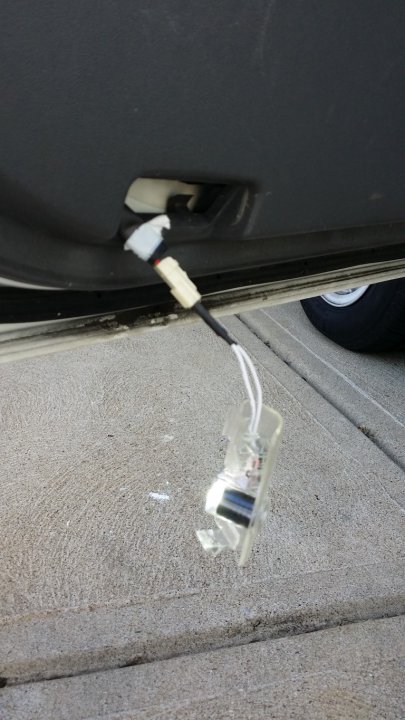

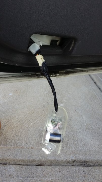

    Pry off the factory door light. Yes I have LED bulbs.
    UNPLUG

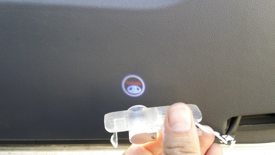

    Top is the NEW GHOST light
    Bottom is OEM
    The GHOST light has 2 small blade like connectors that plug into the OEM socket.

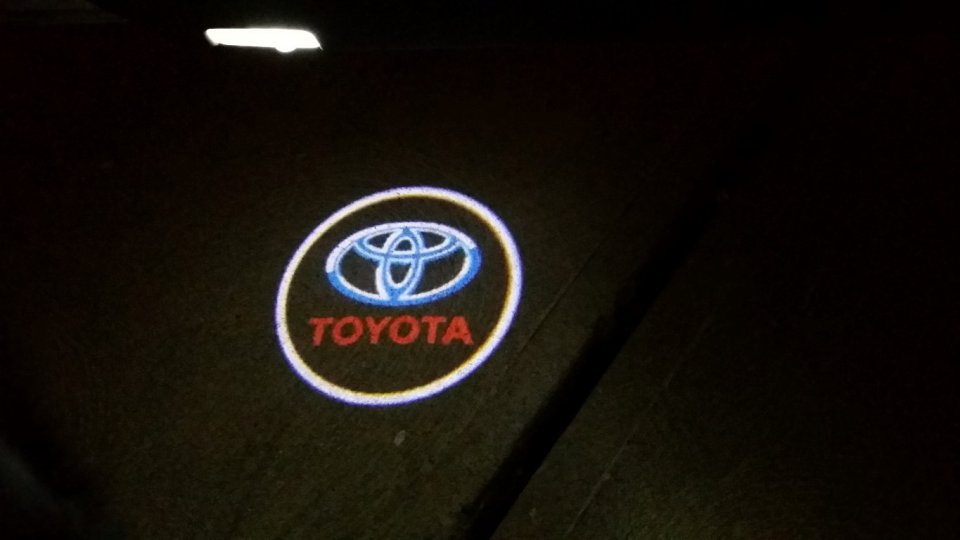

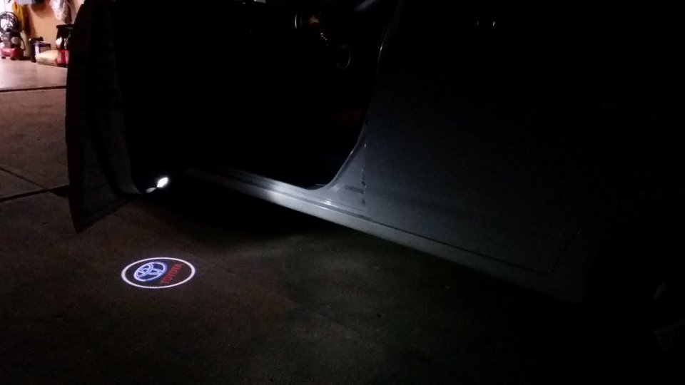

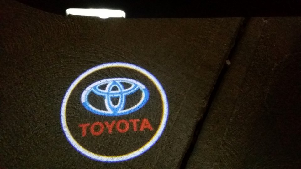

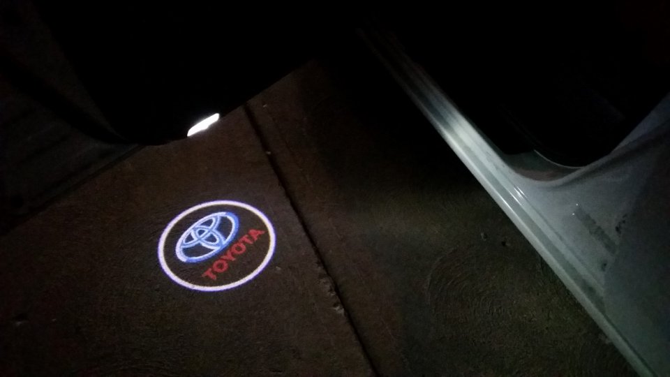

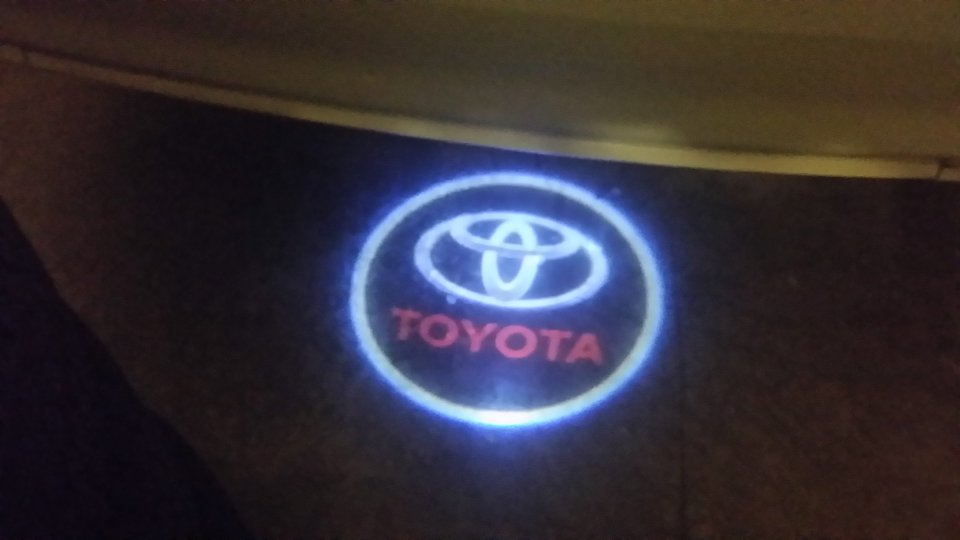

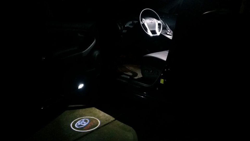

    NIGHT TIME
    Lights up the door better than the factory bulb does still. 20140812_225725 (Medium).jpg
    Yes it does shine back onto the door.

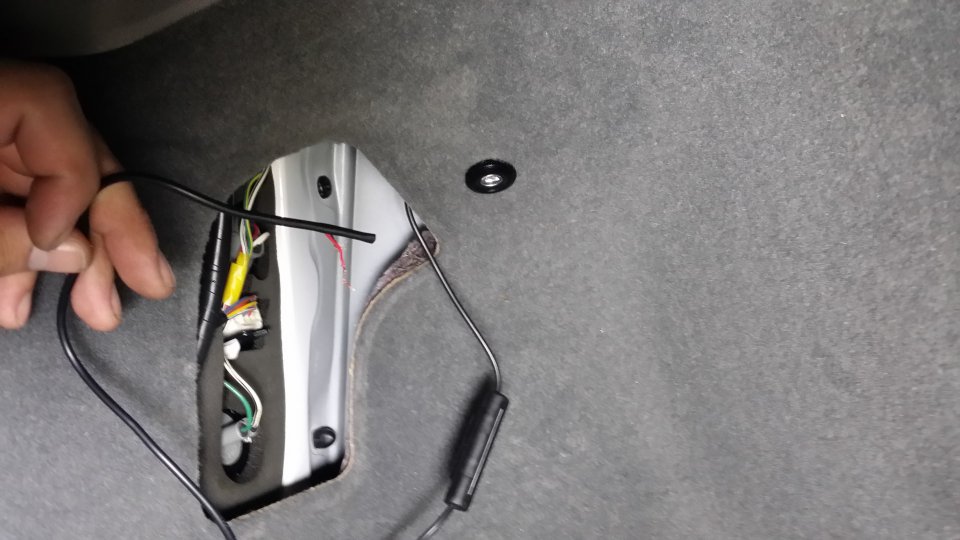

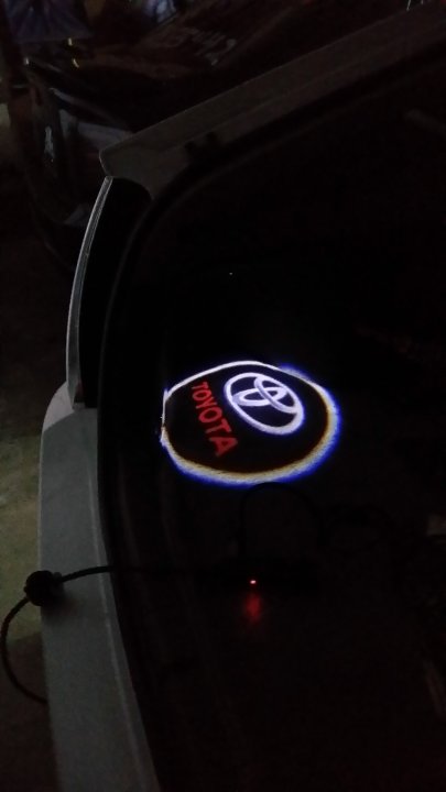

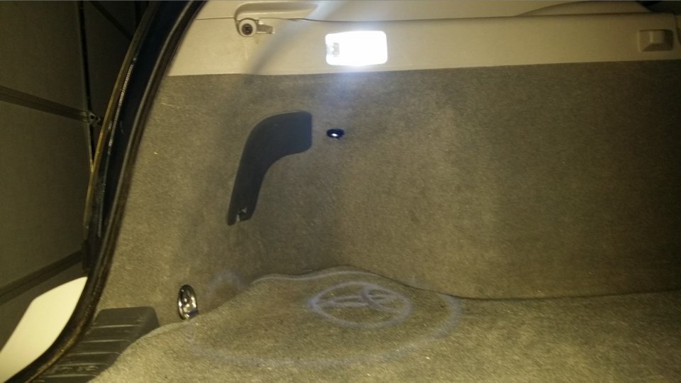

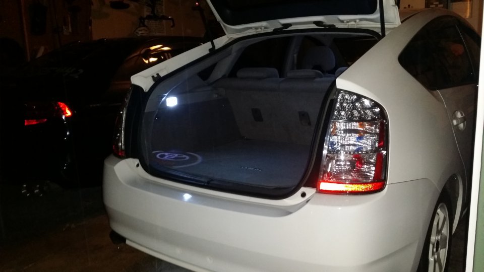

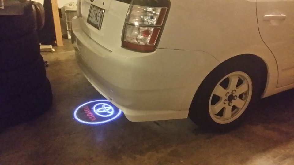

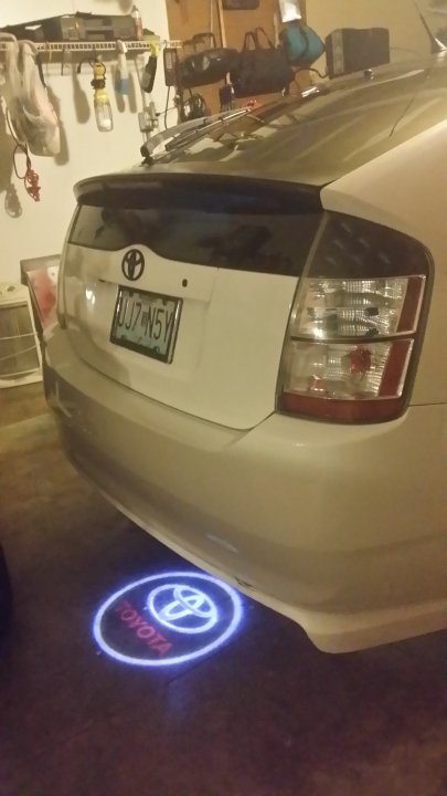

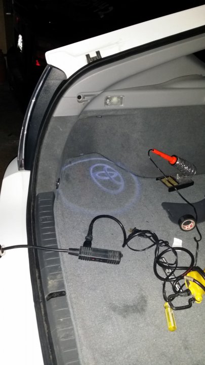

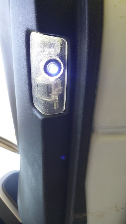

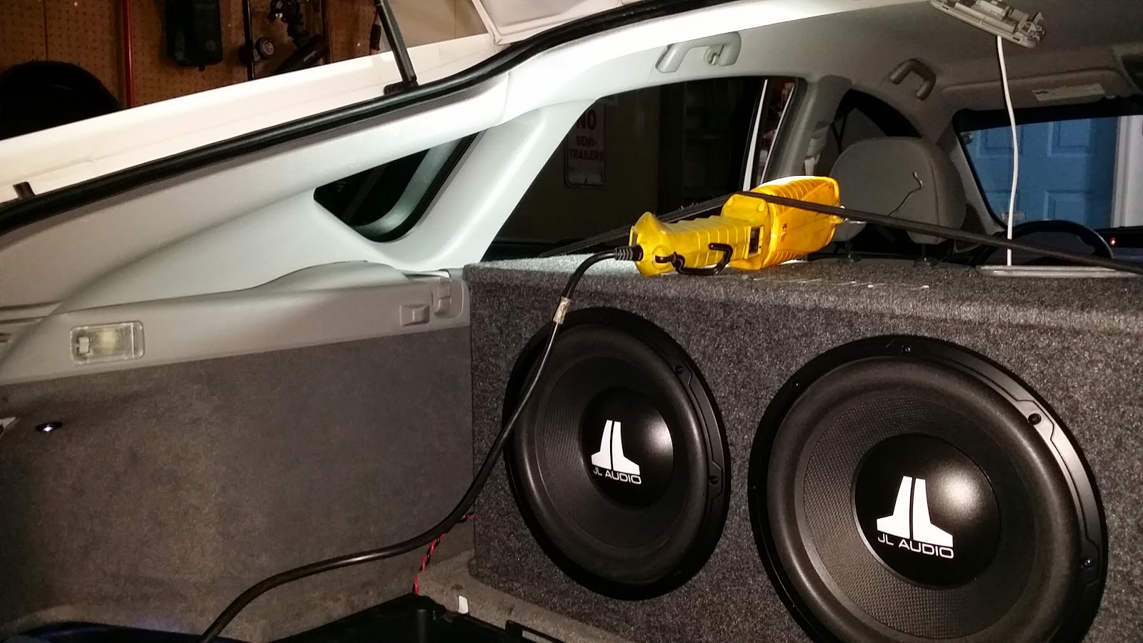

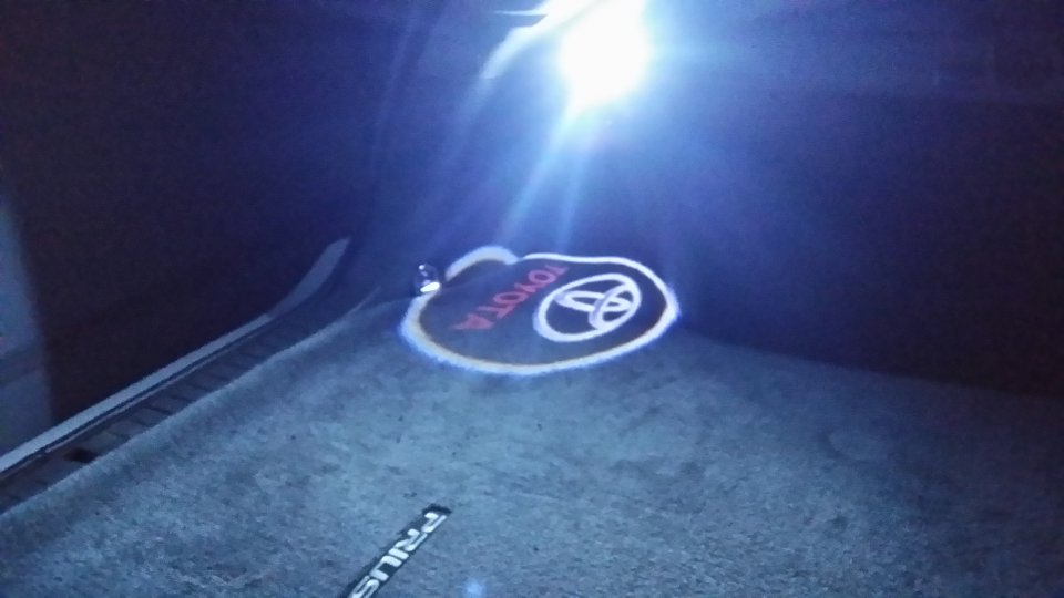

    Got a wild hair and put one in my trunk. Wired into the trunk light power so only comes on when the hatch is lifted and the OEM light can still be switched off. Started out mounting on the hatch aiming down but looked crummy. This is the darkest spot in the trunk so put there instead.
    Drilled a hole with the provided bit.
  18. Sezy
    Sezy Active Member
    Oct 19, 2013
    443
    233
    37
    Saint Charles, Missouri
    2020 Prius Prime
    To stat with this I had to open up my ghost light and add some glue because the logo was loose and would turn anyway it wanted. After this I silicone every part I could. So far it's held up.

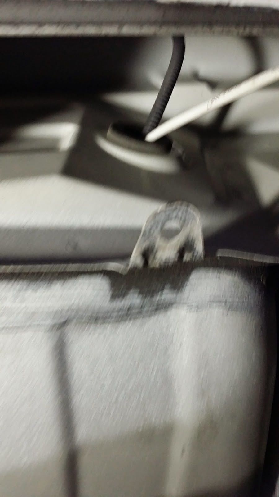

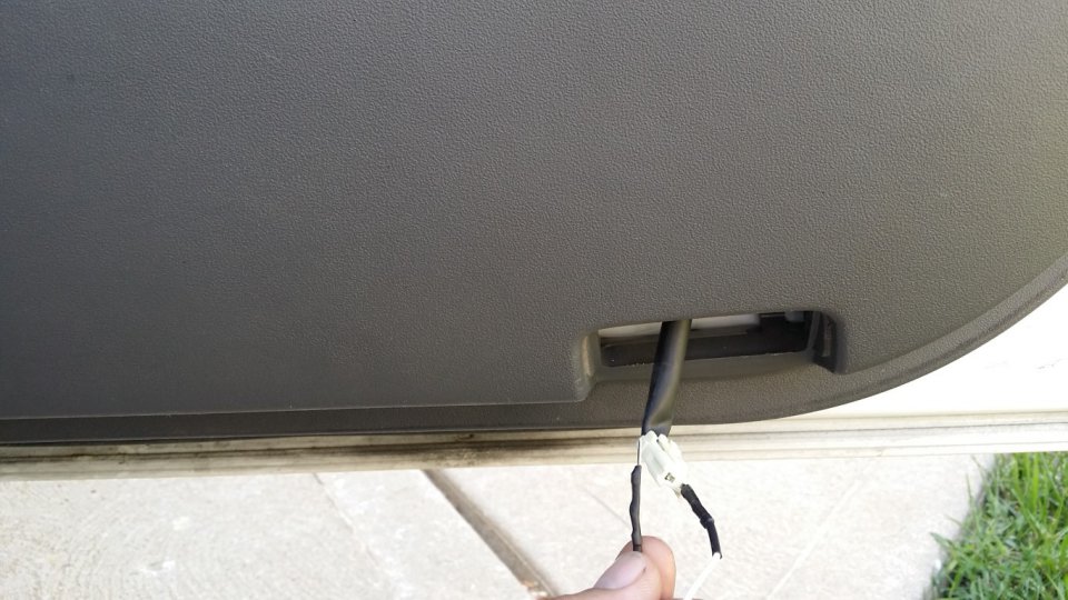

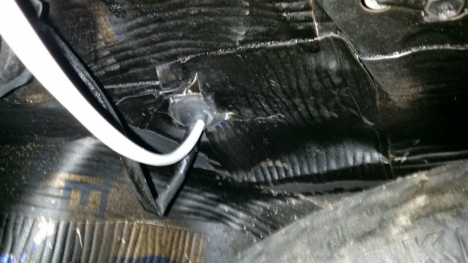

    In the trunk there is a wire already going through a gasket to the lower bumper so I poked through there with my wires.

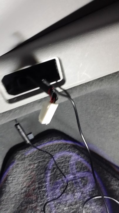

    Ran the wires to the left and up through the pillars. There are 3 clips on the headliner rear that pop out easily. Run the wire through there and to the dome light.

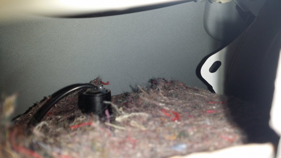

    Kept getting different results trying to tap into the 3 wires on the dome light so I shoved my leads into the mounting tabs of the bulb then added lots of solder. Basically tapping right into the leads for the dome light.
    This is where the wires comes out of the trunk and into the bottom bumper area.
    Find a good spot with some clearance and drill a hole with the drill bit that came with the ghost lights. Should go through 2 layers here. Thread the holding nut on the backside to hold the light in place. Connect and insulate your ghost light wires to the wire we ran to the dome light.
    Had finished pics but my SD card ate them so I'll take more tonight.
