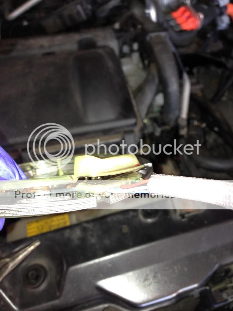

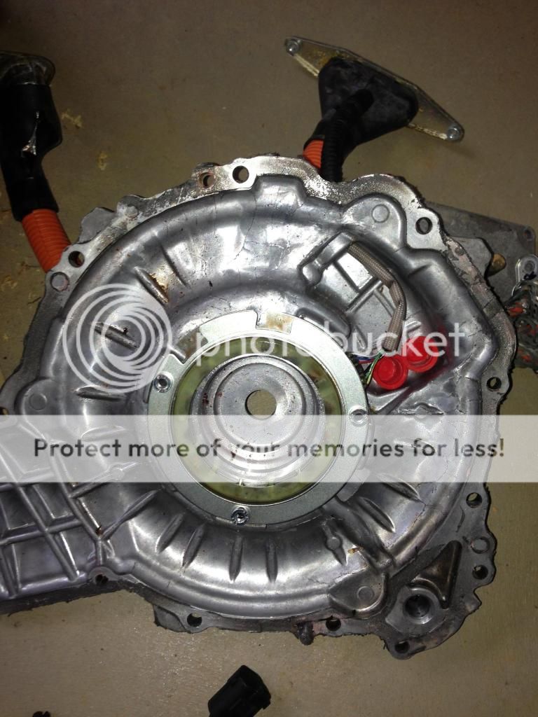

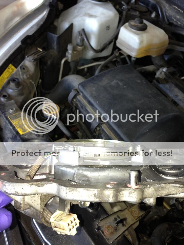

    Okay, here is a pic of the old trans that I took out. See the ring that has the wiring on it. This harness is the one that goes to the plug on the side of the trans closest to the driver side wheel well. If this sensor was not reading correctly would this give me my dtc's?? The reason I ask is because I think I could have I stalled it wrong. I did not bolt it down to the rear cover before I bolted the cover back on. But rather I put everything in place and then tried to pull it to the cover with the bolts.
    Here is a pic of the trans with the cover taken off
    Here is how I am thinking it should have been bolted to the cover before I tried to out everything together. Any input?

    Yes. If any of the MG2 resolver sensor wires were damaged that certainly would cause the DTCs. Toyota does not designate the resolver sensor parts as field-replaceable. If a sensor has failed their solution is to replace the entire transaxle. Perhaps the difficulty you had with the reassembly helps to explain the reason for Toyota's service policy.
    You can test the sensor via ohmmeter checks, per the repair manual.
    I take it then, that this sensor is not related to the wiring harness connector that you had to splice (photos of which were in your post #54)? If that is true then I suggest you identify that damaged connector by referring to the repair manual. Once you know the function of that connector, test the integrity of the wiring harness and your splices, via ohmmeter checks.

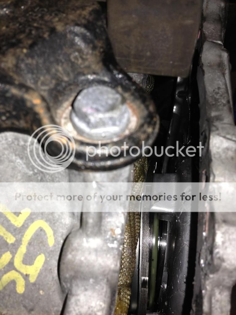

    Okay guys, I have an update. I replaced the battery with a new yellow top, then I decided to take the rear cover off of the trans again because that was the only area I really had an issue with when swapping the trans. Here is what I saw when I first cracked the cover...the round sensor was not mounted flat against the cover.

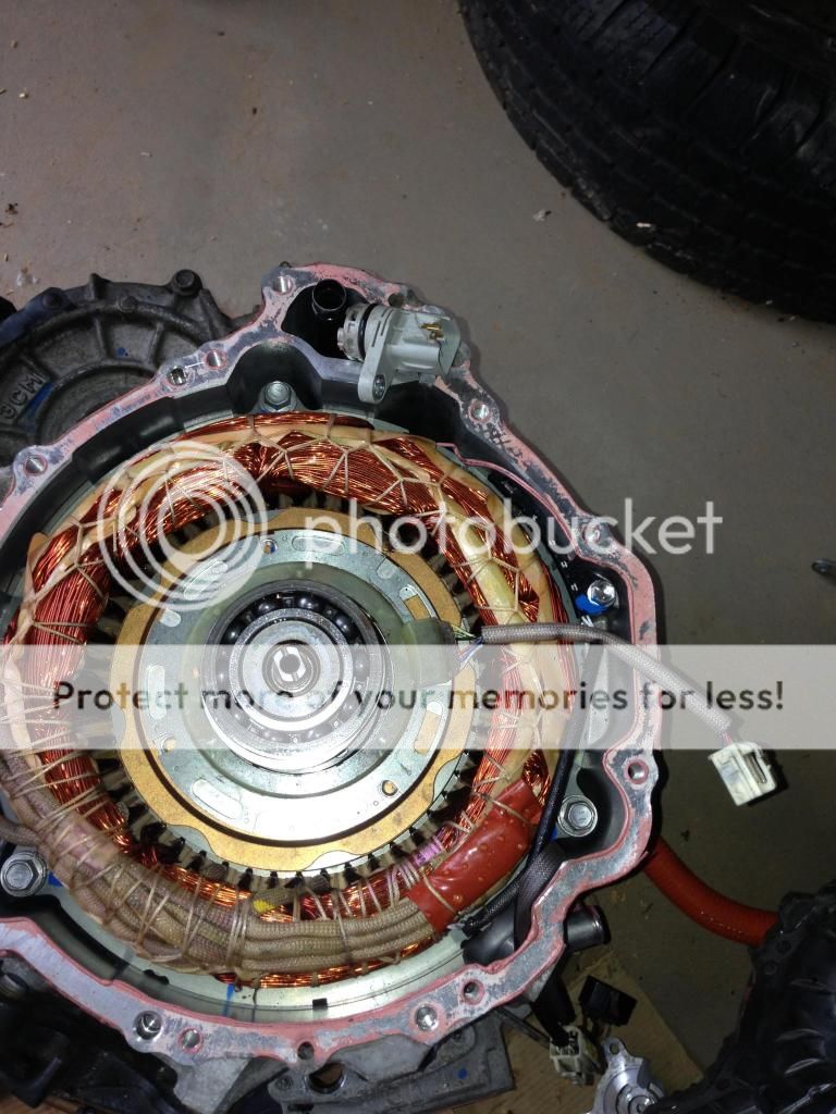

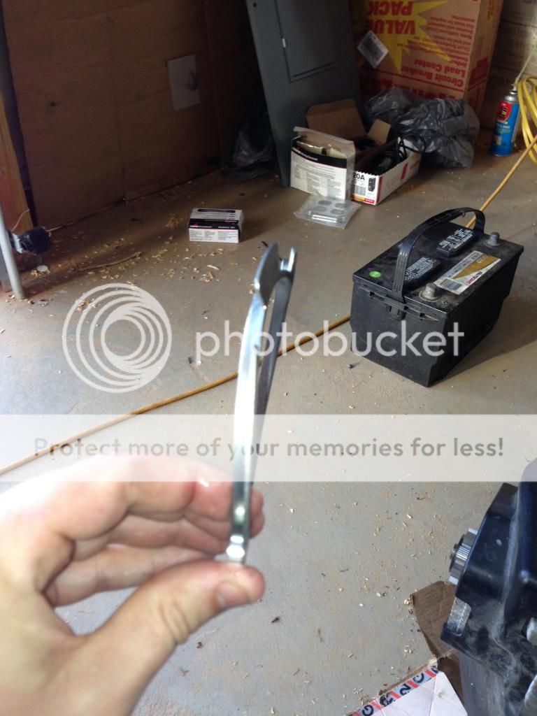

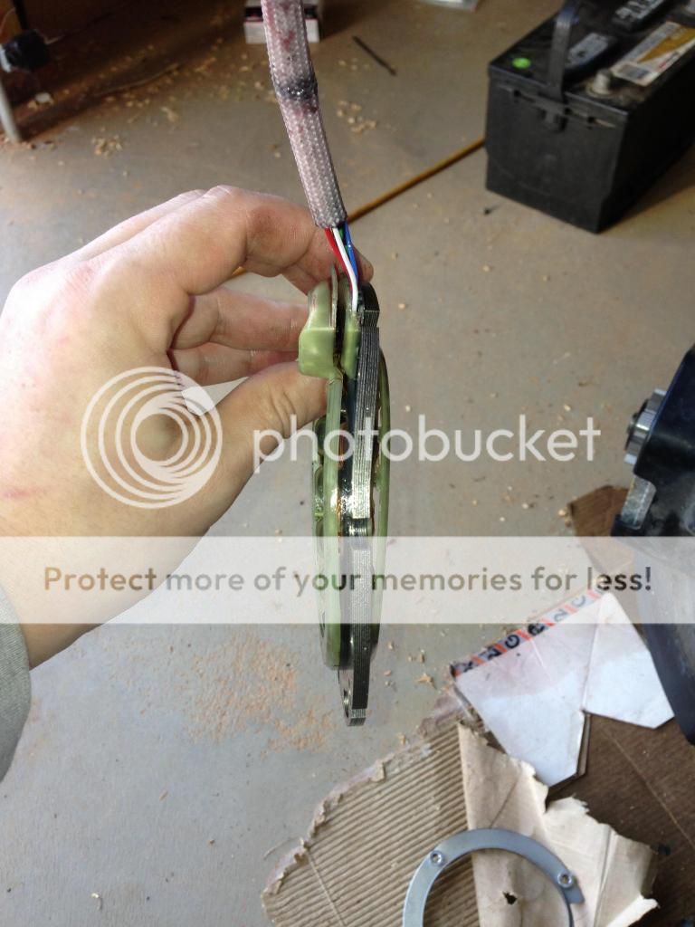

    So I finished pulling the cover off and pulled the sensor and mounting ring off. I'll let the pics do the talking.
    So I got the sensor and mounting ring off of the original trans that I pulled and installed it flush on the cover. Then I put the cover back on.
    When I went to "start" the car for the first time I saw something I had not seen since I started the swap...the "Ready" light! And the dash was not all lit up. The car actually went into D and R.

    When I installed it I put the cover on first before the 3 mounting bolts were installed. So I put the bolts in once the cover was on. I used a longer bolt to hold the sensor in place....obviously it did not work well. I knew something was probable not 100% correct because I had to use one longer bolt when mounting the sensor because the factory bolt would not reach.
    The lesson here is that if you ever do this either do not remove the three mounting bolts in the center that hold this sensor in place (again I have never worked on a Prius before this so I just assumed these 3 bolts were bolts that held the rear trans case cover on). Or if you do remove them make sure you mount the sensor in place/flush on the cover before it is reinstalled.

    Good to see that you were able to replace the warped (failed) position sensor. Excellent photos.
