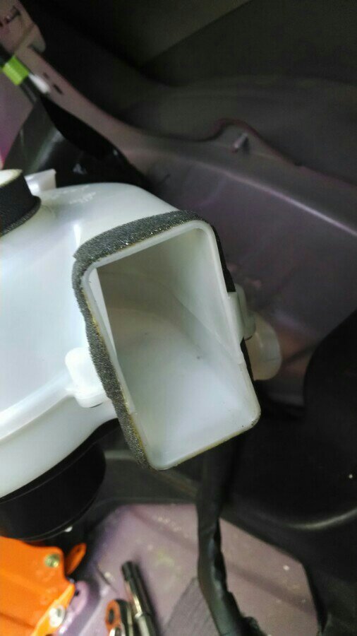

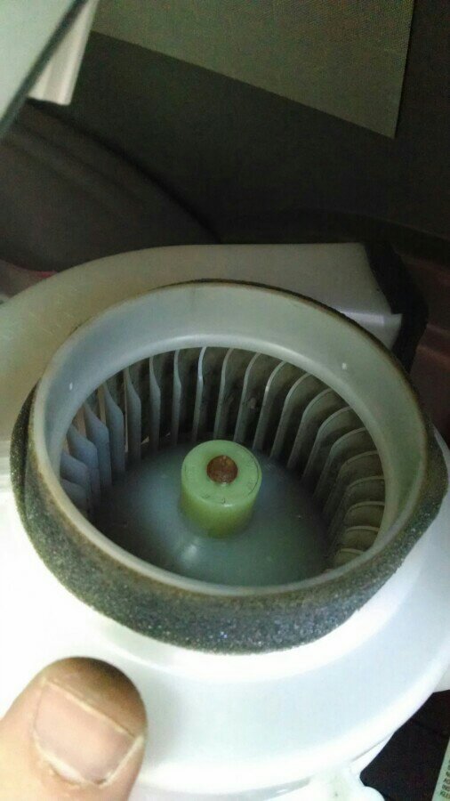

  18. lexforme
    lexforme Junior Member
    Jul 13, 2014
    Greenville SC
    This is what it looks like inside the fan. Pretty clean.
    XT1080 ?

  20. lexforme
    Jul 13, 2014
    Greenville SC
    Could this be possible cell leakage? This was here before the reman battery was installed. It's just below the tube.
