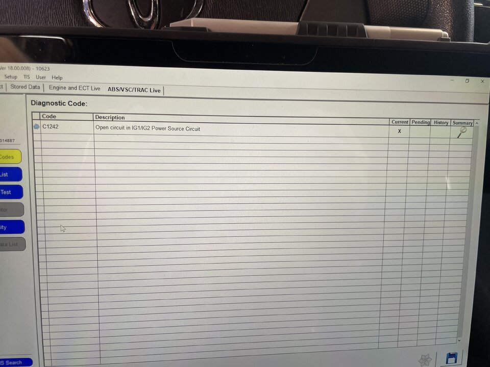

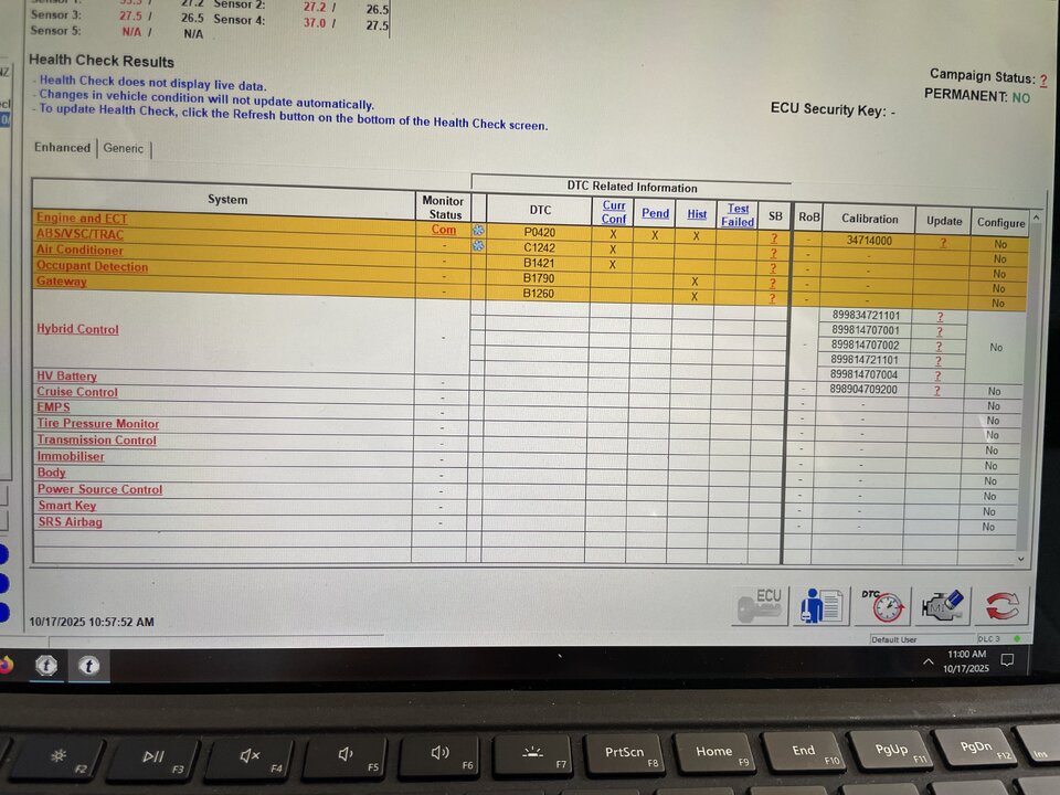

    So I was moving the car since it’s street cleaning the cel light came on but the car did not die. Here’s the code

    wont that give a inverter pump code? do you think its the brake switch?

    No. There is no code for a dead inverter coolant water pump. The water pump and the radiator cooling fans both become suspect when you get an "Inverter is Too Hot" code, P0A93. More often, you get that code because it is the pump has died, but you should not automatically rule out the radiator fans either.
    No. P1242 is about 12-volt power arriving at the IG2 input to the ABS ECU. There could be many causes for that, so going through the diagnostic tree for that code is advisable.
    Yes, you can unplug both while the car is running. The car will not "die" by just unplugging the inverter coolant water pump. It should "die" if you remove the AM2 fuse.

    No. It just means the fuse is not the problem, and if the car does not die, then you've got a weird conundrum. The car should die when you remove the fuse, which proves the fuse is good. You could also prove the fuse is good by using an ohmmeter to check for continuity.
    Following the diagnostic tree in the repair manual for the code is the best way to narrow down the problem.
    Your codes don't implicate the water pump in any case, but you can rule it out quite easily by checking the coolant reservoir for fluid movement. If there is no movement with the car IG-ON (two presses of power with foot OFF the brake) or READY (one press of power with foot ON the brake), then the pump is not working.

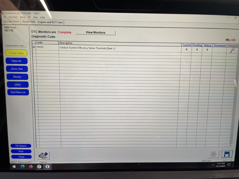

    will a bad inverter pump give a p0420 code too? or im just bad luk that the cat also dies?

    No most people would never even know they had a bad inverter pump unless it's 85° out and you've got a 40 minute plus drive and red vtriangle was broke and MFD out . the code for the catalyst below threshold is the cars generated self test of its catalyst and it fails . Cat replacement is happening or it no reauired in you're locale like mine.
