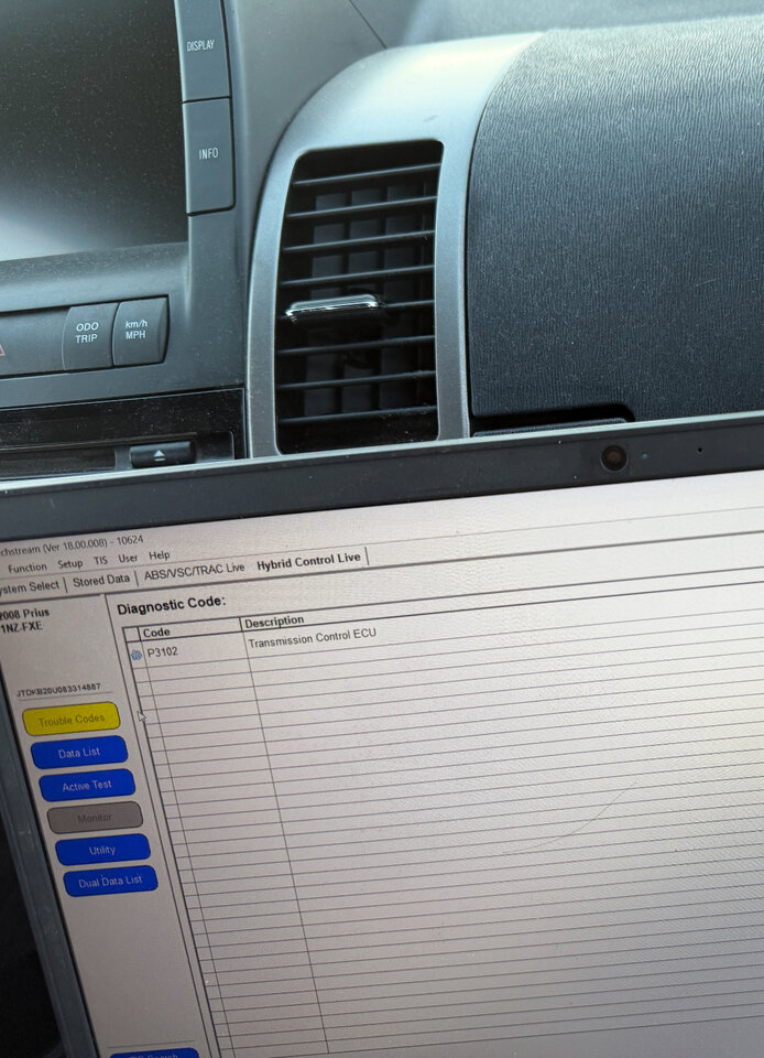

    just an update. I replaced the inverter pump today and drive the car and died again checked the code and it gives a P3102 Transmission Control ECU Code

  2. dolj
    dolj Senior Member
    May 14, 2012
    8,652
    4,403
    Wellington, New Zealand
    There are seven INF codes for that DTC: 524, 525, 581, 582, 597, 598, and 599.
    Clicking on the snowflake icon right there on the left of your screen will tell you which INF code you have. Knowing the code helps to follow the correct diagnostic procedure.
    With two of the INF codes, the car is impossible to drive. The other five talk about the shift position being fixed or not, and the car being impossible to drive or not is dependent on that position being fixed or not.
    There is also mention of communication problems between the BEAN and the transmission control ECU assembly.
    In short there are too many possibilities without the INF code.
    It is not clear from the context whether the meaning of the word fixed means corrected/repaired or stuck in place.
  3. richard203
    richard203 Member
    Jan 23, 2019
    284
    61
    SF
    ----USA----
    here’s the INF Code - 3102-525
  4. dolj
    dolj Senior Member
    May 14, 2012
    8,652
    4,403
    DTC P3102/525 indicates a malfunction in the transmission control ECU. This code is often associated with issues in the park lock system or the park lock actuator motor. It can lead to problems with shifting gears or engaging the park position.
    For detailed repair procedures, refer to the official Toyota repair manual for the 2008 Prius. This manual will provide specific instructions, wiring diagrams, and troubleshooting steps tailored to your vehicle.
    Toyota Service Information and Where To Find It.
