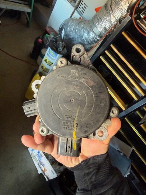

    UPDATE - I let my friend do the diagnose, since I don't got much time to do it. He followed the procedure to rule out if the car needed all three ECU. he say all three ECU is fine from what the procedure says. Next he thinking its the Shift Control Actuator and he got a used one laying around. When he took the old one out he show that the old one is not the original Shift Control Actuator because it got a yellow marker line on it, original Shift Control Actuator shouldn't have a yellow marker line on it only junkyard seller do that. Once he installed his used Shift Control Actuator and did a 1 hr local test drive, he say the car did not die. I will update again if it ever come back or still. I will post the procedure for the future people and post the pic of the old used Shift Control Actuator that were on the car.
    Aegean likes this.

    That's parking lock motor I believe. park on a level surface is indicated on mfd

    ya i was shock too since the code procedure was indicating its either the wiring/connector or 3ecu is bad. I didn't expect replacing that part will fix it. I will update if the code ever come back

    Not sure about yellow marks the Prius has yellow magenta and lt blue marks all over its parts at least my federal cars do . That yellow from salvage yards here will usually be letters like WAP which is Wagner's Auto Parts here in yellow on Tuesday on Wed it blue.
