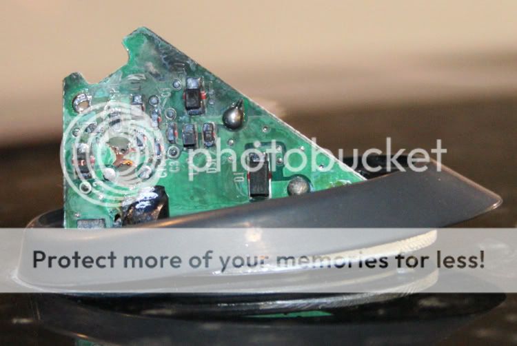

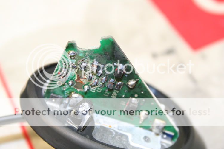

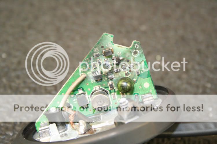

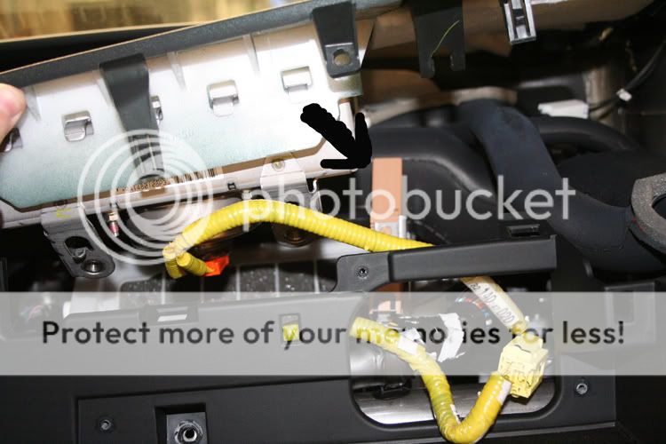

    Anywho.... Here are the pics I have so far... First is the antenna, on the car then both sides on the bench. Next is the locknut. (Note the burn marks) Finally, is the location of the gateway ECU, located next to the passenger dash airbag. (Brown box) Awaiting insurance company to authorize engine ECU, Hybrid ECU, and HV Battery ECU.
    More pics and info will be coming as I continue this winding path of diagnosis.... Hopefully, things will progress quickly and cleanly for the sake of the owner and all involved...
