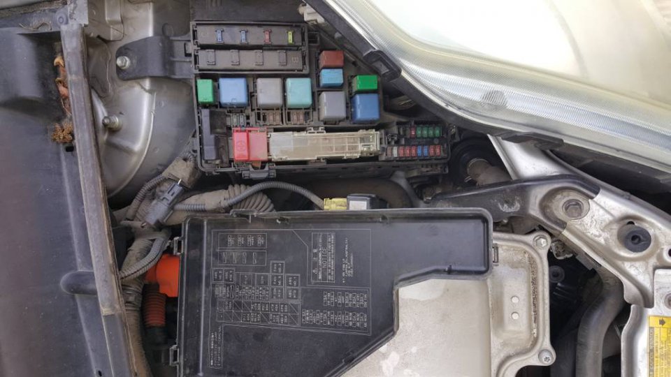

    I am hearing a click in the fuse box when the sound comes and go. Can I pull the fuse to see if it goes away so I can help pin point where the sound is coming?

    It is enough to remove the relay from the socket to stop the voltage supply to the system.
    This is usually done when eliminating leaks in the brake system or replacing parts.

    Could you tell me which one it would be? Is there a diagram that would help.
    I don't have the owners manual to help with identifying which relay/ fuse to pull.

    The relays are labeled on the box cover.
    In the photo, there are two blue relays, next to green relays.
    Removing them from their sockets will not supply power to the ABS pumps.

    Awesome this is very helpful thank you!
    Just for clarification, the brake accumulator (entire abs system) will not work after pulling those relays? I'm sure it will throw codes but i can just clear them?
