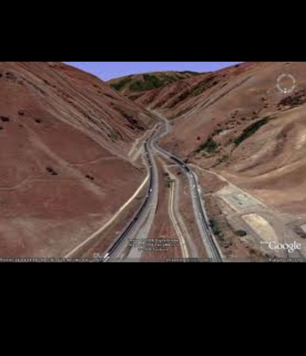

    The Grapevine cannot be appreciated until you did the climb and decent. There have been train wrecks on it.

    woah. off topic, but your info on the rail line thru Tejon caused me to stumble across the Tehachapi Loop. Pretty awesome stuff.
    Anyways, it's not just the Tejon Pass. I-5 is a pain that entire stretch between Santa Clarita (where Route 14 splits off) and Grapevine. It's common to see disabled cars waiting for tows, even the nice new models (that is, if you're of the mind that Mercedes and BMWs are 'nice'). Semis take that stretch niiice and sloow, 20mph in the right lane.
