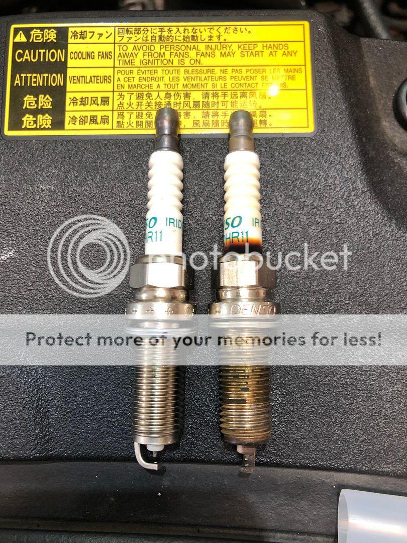

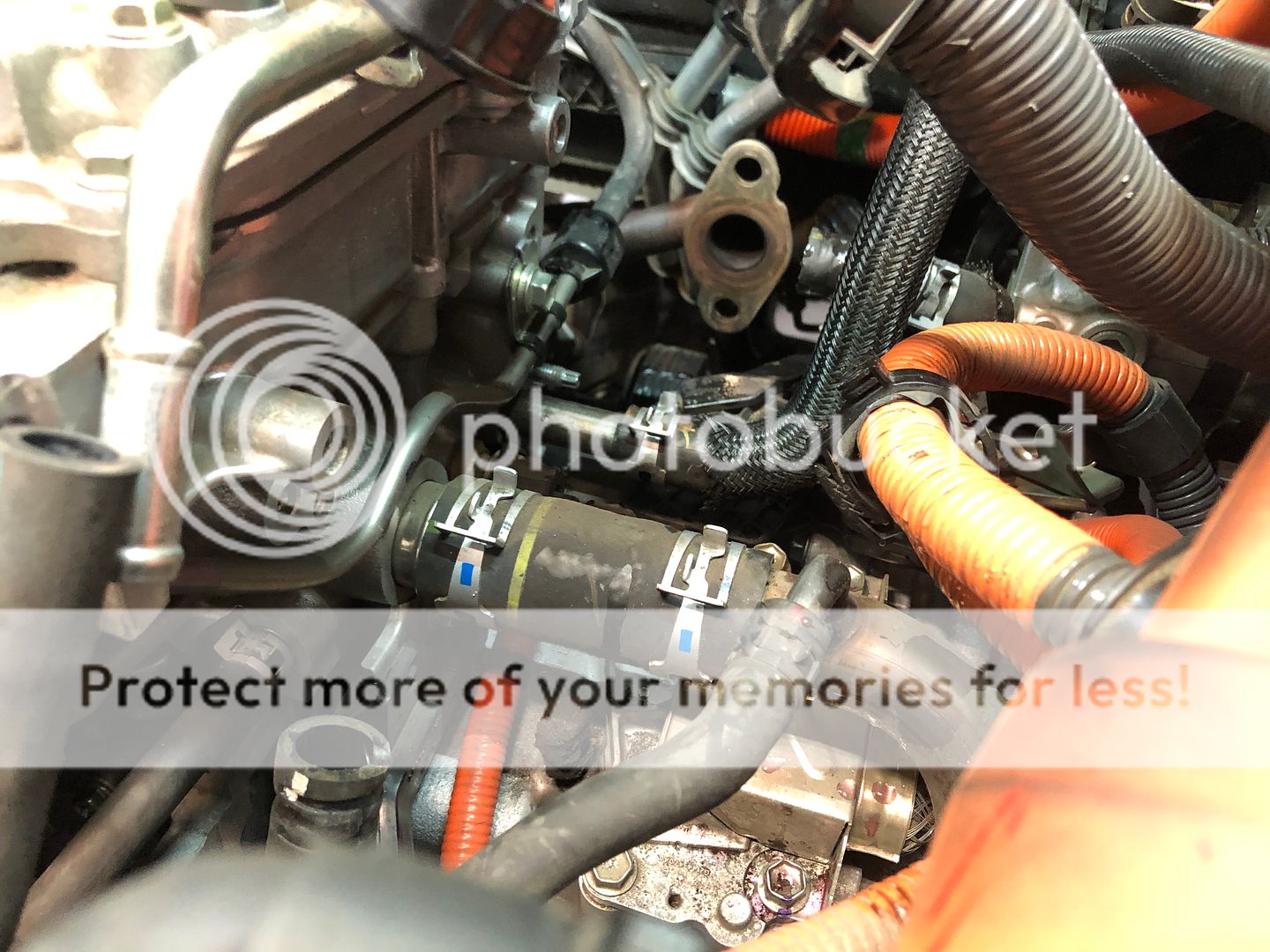

    I just spent all day doing maintenance on my wife's 2010 Prius. I changed the oil and filter, CVT fluid. spark plugs, upgraded the VVT-i solenoid to a Quantum Solenoid, changed the engine coolant and both radiator hoses, inverter coolant, and removed my EGR cooler and swapped in a clean one as mine was completely plugged. That was a PITA to do. I sure wish that they designed that better to make servicing it easier as those back 2 bolts and the hidden one under the cooler are a nightmare to reach. I wonder what a dealer would charge for everything I did today? I have a new 12V battery to install also since it still has the original one.
    A couple months ago I replaced the PCV valve and installed an oil catch can. I cleaned the intake manifold and throttle body at that time.
