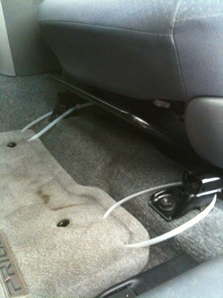

    Nixa, MO
    Some of you saw this on FB, but the 2009 rental Prius they gave me has the original "fix" that Toyota proposed, though not how I would have implemented it. Notice that they just cut holes in the mat instead of using the reinforced preexisting holes! Lovely eh!
