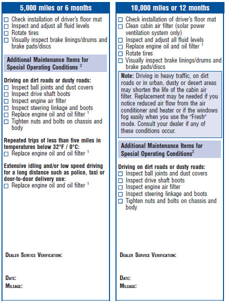

    OK, enough with BS! Can anyone point me where it says 10K miles in owner manual?
    The maintenance booklet still states 5K miles or every 6 months.

    In Canada it's 8000 km (~5000 mi) or 6 months. But in the States Toyota's saying 10,000 miles or yearly, whichever comes first. This is from a pdf from US Warranty and Maintenance Guide:

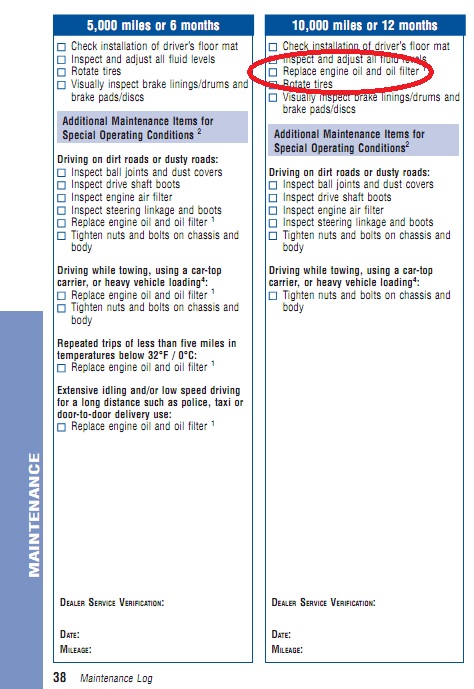

    Page 38 in the US 2012 Warranty and maintenance manual..

    Thank you! That red thingie helped a lot!!!
