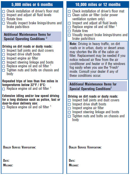

    Well as far as Toyota verification of the 10K oil change, the thread in which the official announcement was made, including feedback from The Prius Team and official verification is actually a "sticky" in the Gen 3 Prius maintenance forum.
    Some 2010 Toyota Vehicle Oil Change Intervals Officially Revised To 10000 miles/1 year (verified!) | PriusChat
    I think we can debate whether WE personally believe in the practice, but the fact that Toyota currently promotes the 10K oil change with the Prius is established fact.

    3) As several people have pointed out, severe conditions usually consist of multiple short trips, stop and go traffic, etc. where the car never really gets up to operating temperature, and thus doesn't burn off the toxic contaminants produced by the combustion process. By definition, the Prius engine is operated under severe conditions, since the engine is constantly being switched on and off. Amsoil, the biggest proponent of synthetic oils reccomends a 7500 mile interval for their extended service oil WITH A FILTER CHANGE PARTWAY THROUGH the 7500 miles.
    If I'm going to change the filter, I most definitely will be changing the oil.
