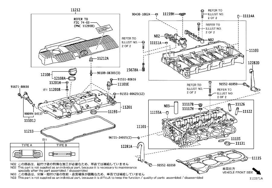

    With the valve cover removed, you find it in the front cam bearing cap.

    Do you have a part number?

    I wasn't able to find one. It's not shown on the cylinder head parts breakdown. That bearing cap is illustrated but not offered for separate sale, as it and the camshaft housing sub-assembly are machined together.

    I lied (or I looked before they updated something, but probably I just lied).
    It is callout 15678A in this cylinder head diagram.
    2010 Toyota Prius Filter, oil control valve. Engine - 156780V010 - Genuine Toyota Part
    I would not recommend anyone disassemble their engine down to the cam bearing caps for the purpose of checking this little screen, if there isn't some other good reason for that kind of disassembly. Certainly not as an alternative to more-frequent oil changes.
