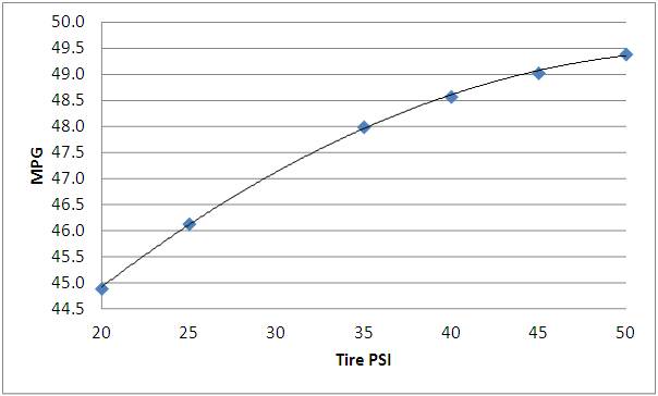

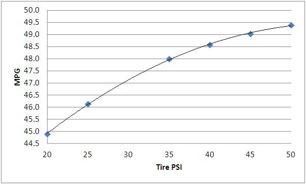

    Re: Effect of Tire Pressure- I have previously shown this chart (below), based on some equations, but I did not have actual Prius MPG data so it's the shape of the plot that's important. As you go to too low pressures, the MPG decrease worsens. FuelEconomy.gov say impacts is: "You can improve your gas mileage by up to 3.3% by keeping your tires inflated to the proper pressure. Under-inflated tires can lower gas mileage by 0.3% for every 1 psi drop in pressure of all four tires." But other sources say the effect much larger than EPA says it is...so I do not know.
    I've noticed with my Gen2 sometimes I am getting 50 MPG on the display, then stop to get gas... then it won't go over 45 MPG on the display. I tend to feel real MPG is best calc'ed via hand at fill-up. But then we have (in Gen2) that flexible guess tank so we have a hard time with these sorts of measurements.
    Here's some MPG data from Edmunds:
