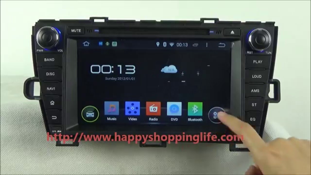

  12. 12voltman
    12voltman Member
    Jan 26, 2015
    124
    93
    So, does anyone know a way to update the operating system from a 4.4.4 to 5.1 or higher ?
    I am guessing its not possible ......
    Also ....... silly question , but on my "home" screen , the weather widget never works, and is always up on the screen (when I am not using bluetooth, radio, cd/dvd or something else) . Is there any way to get rid of the non working home screen weather widget thats next to the clock ?
    It looks like this .........
    See how the weather widget is also not working on the one in the picture !
    I want to get rid of it , or at least find out how its gets its info , so it works !
    Thanks !
