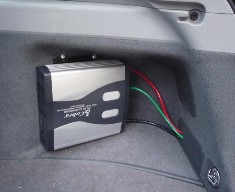

    I mounted one like this:
    bwilson4web likes this.

    AC compressor is likely to have a signficant power spike at startup - putting alot of strain on any inverter-battery-generator system so I'm not surprised at what happen -but your setup probably could do something less ambitious like run a laptop or a ham radio. The circuit breaker is a great addition but I am wondering if there isn't something else you could do to prevent draining the 12VDC battery too far (e.g. a low battery power alert /shut off system) . It would really be cool if there was a Prius upgrade/accessory so the Prius ICE could double as a backup generator - Something like that might even have a RV/Camping market potential.
  20. bwilson4web
    29,097
    16,533
    Nicely done!
    I tried to read the watts but no luck. I also checked the current Cobra web site and it looks like they now have LCD read-outs. What I didn't find was whether these are modified sine-wave (price suggests they are) and their rated efficiency.
    How long have you had it?
    Thanks,
