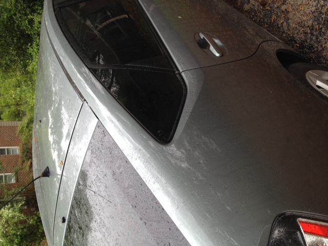

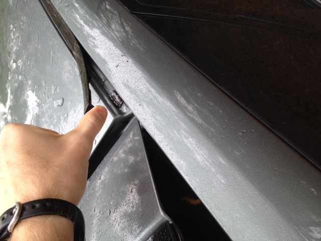

  16. kuz
    kuz New Member
    Mar 12, 2014
    Athens, GA
    I was having the same issue. My car would smell musty after hard rains and I couldn't find any moisture in the car (checked all the carpet all the seams). Finally, when looking at my 12v aux I noticed 2-3 inches of water sitting under it. I couldn't figure out where the leak was coming from and I ended up on this thread. It took me a while to understand what I was looking for so I'll ad a few pictures zoomed out for anyone that is confused by the placement of the crack.
    I have a small crack in the same spot as the op so I'll try some silicon on it or something simple at first and see if it helps. Great work, saved me a ton of time trying to figure out where it might be coming from. (the crack is really small but I could see how over time it could add up).

  17. spuddybuddy
    spuddybuddy Junior Member
    Feb 9, 2009
    Seattle, WA
    Found about one inch of water underneath my accessory battery when I went to replace it yesterday. Found this post and lo and behold, a tiny crack behind the retaining clip for the roof trim (just like khp reported). Will try to get some silicone sealant on it before the next rain.
