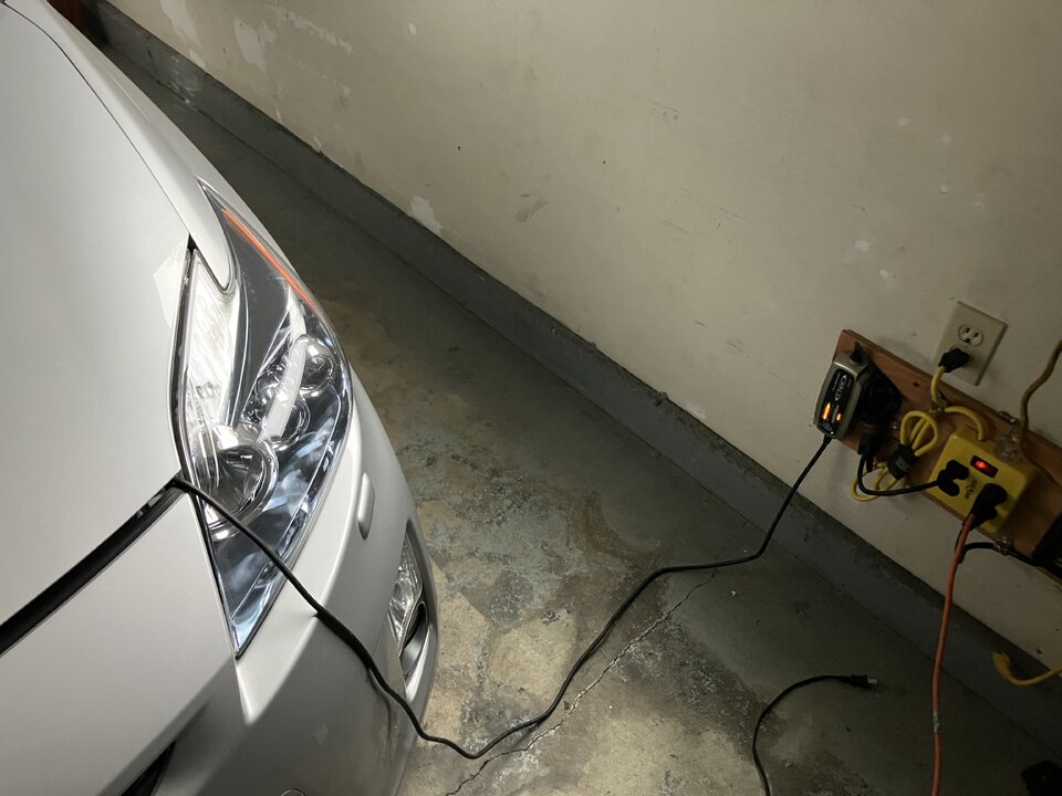

    No gap over the headlamp to route the AC cable, unlike in my Gen 4 Prime? I can easily close the hood with the cable still loosely sliding.
    Beware of Chinese battery maintainers.
    I thought you didn't have a garage. Perhaps get a PHEV instead of an HEV?

    Here is how I route the AC cable of the Noco Genius through the gap over the quad LED headlamp of my 2021 Prius Prime Limited. The gap is pretty wide, and the cable fits through loosely with the hood closed.

    On mine the hood can stay open, just lowered until it clicks, to allow room for the cord. The dash light goes off after a few minutes.
