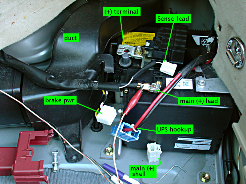

    The high temperature is worrying, batteries are not supposed to be that hot. They might be if there is a bad connection, so that all the current goes through a very small contact area or too small a wire. A loose connection to the post will do that, effectively it reduces the contact area.
    There is a picture here:
    showing what it should look like with the red cap off, the positive terminal connector off, and everything unplugged. Ignoring the red alligator clip and the UPS wire (not standard wiring), were all the wires you saw like this?

    Thanks for the great reference image and response. I'm thinking my addled brain inverted what I saw, but using your picture, there was a single wire (looking at it now I'm guessing it might have been the Sense lead, as you've labeled it) that had its end stripped and it was shoved into the female receiving end to the right of the terminal clamp, which was directly under the Sense lead label that you supplied. The male end was missing, and given the size and configuration of the connector, I apparently wrongly assumed that there was supposed to be more than one wire connecting there. So much for assumptions...
    The ground cable was clean and solidly connected on both ends, and the positive clamp was similarly affixed and without corrosion. The red plastic shield was missing, so the main lead crimp connection was quite visible, but it too was clean, well attached, and devoid of any corrosion or malformation. It is also where the extreme heat was exhibited, which is what led me to search for a possible skinned wire or short nearby, but nothing was obvious. As mentioned, I had no test gear unfortunately.

    I do not like hearing that the main lead was getting that hot. I wonder if there could be some oxidation on the mating surfaces of that connector.
    Sometimes just unplugging and re-plugging it a few times will help.
    If the 12 volt battery was very low on charge (or, worse, had an internally shorted cell) then there could have been heavy charging current going through that connection.
    It's not great that the sense lead is just jammed in there, but it doesn't carry high current, so it shouldn't get hot. If it were mine I would buy the repair terminal and put it back in the connector housing and plug it in properly.

    If the A/C compressor was pulling enough current through normal battery cables and connectors to cause that much heat it would blow its fuse in very short order, if not also the main fuse. I suppose it's possible that the battery post itself is defective somehow, so that the heat is being generated in the battery below the post, but if so it is surely toast as that would have baked an AGM dry in no time. That really doesn't seem likely to me. (The post part, if it really was that hot, the AGM might well have been damaged even if the heat came from above.)
    Defective main fuse??? Seems unlikely, but it is in that location, and all the current goes through it. I guess if it was somehow not mounted properly it might create a "too small current path" problem. If the owner gets one off a wreck (should be cheap, can't imagine that there is much demand for them, never heard of one even being suspected of being bad before) and swaps it in that would pretty much definitively rule out a a main fuse issue of any type.
    Still seems most likely that there was some sort of crud on the post or clamp, not necessarily visible to the naked eye, which was insulating much of the surface. With most of the current going through a fraction of the intended path a large amount of heat would be generated. I would suggest the owner use a battery post cleaner and clean both the outside of the post and the inside of the clamp.
