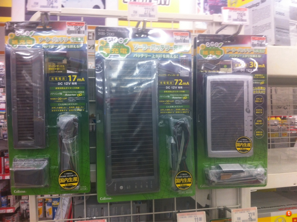

    Good day to all
    Need some help regarding solar charger for our 12v , as the picture shown manage to found 3 type of solar charger typically use for charging 12v . Will the 17Ma sufficient enough to charge if park under hot sun for 4-5 hour each day ? Thanks and FYI I'm from malaysia which our weather can reach 35-38c each day

    What is the price difference between each model?

    17ma in Convert to US dollar will be around $30, 36ma around $60 and 72 around $80

    Your 12-Volt battery is something like 30 AH. So it will take 3000 mA (3 A) for 10 hours to charge. none of those solar panels will be able to CHARGE it. The biggest one probably will be Ok to MAINTAIN the current charge if you park the car for a long time, i.e. it will not discharge. Also, I would connect this panel via diode, just in case.

    Another way to look at it is this: What is the value of the energy produced by such a device?
    An optimistic view is that you might get ~5 hrs of max power output per day on average. The biggest model at 72mA would then make about 4.32Wh of electricity per day.
    Our electricity average in US costs ~11c/kWh, so the value of that energy would be about 0.0475c per day or 17.3c per year. This would be the case compared to running battery tender / float charger at home.
    Looking at it another way, without a battery tender your ICE in the Prius may run a little bit extra to replace the energy from the HV battery used to replace that amount of energy into the 12V battery. A gallon of gasoline contains about 33kWh of energy, so assuming 30% net efficiency from the ICE, generator, and dc converter that would be about 10kWh worth of electricity per gallon. So that 4.32Wh would equate to about 0.0003927 gallons per day, or 0.143 gallons per year. At $3.50 per gallon, that's about 50c per year worth of fuel.
    In either case it would be hard to justify the $80 purchase price. Small solar units like this are often very cost inefficient. Again using US numbers, the cost of installing larger scale solar on your house is now in the neighborhood of $3 per dc rated watt. This unit at 12V / 72mA would be 0.864 dc rate watts, so that's about $92.60 per dc rated watt.
    Another thing to consider, particularly in a warm climate is will you waste more gas by parking in full sun and then having to cool the cabin with AC vs. parking in the shade? I imagine that's pretty likely.

    None of these will do anything for you.. I have not measured the draw on a Prius C, but on my old 2001 Classic, I remember calculating that you needed a minimum of a 5 Watt panel for any charge to be put into the battery at all; anything smaller, and all you're doing is slightly offsetting the draw of the vehicle electronics (anti-theft system, etc that remains active, even when the vehicle is off).. If you can, find crystalline panels vs. amorphous panels: the crystalline panels are generally blue/black in color and you may see the crystalline structure of the silicon, vs. amorphous panels which are brownish in color and absolutely smooth.. The crystalline panels are more expensive, but more efficient as well, so for the same wattage, a crystalline panel will be much smaller than an amorphous panel.
    On my classic, I had a 15 Watt crystalline panel (about 12x 10") in the back window with a charge controller (to prevent overcharge) connected to the 12V battery to keep it topped up (in Canada, I would have been getting several amps (not just milliamps) of charge current (after accounting for the electronics draw) during peak sunlight hours, which would be enough to keep the battery topped up), and I'd like to hook something similar up in the C2, but I'm still trying to figure out where to put the panel.. The rear window is out because due to the more vertical window surface and the presence of the spoiler, it is way too shaded and would not allow the cell to generate much current.. I'm currently thinking about the front dash: the surface of the cowl over the centre display- a good sized area that is not going to interfere with airbags, etc. Probably enough for a 10W crystalline panel, or maybe 15 or even 20W if I buy individual cells, and directly surface mount them on the dash and wire them up myself..

    Thanks for your info , so even if I choose the 72ma won't help in charging 12v battery in my country ?
    Some of our Prius 3rd gen here need to change their 12v battery in 2-3 years of usage .prius c 1 case in 2 years of usage .
    What I'm thinking is will adding a solar charger help to extend our 12v battery while it is in parking .
    My measurement on the 12v is 12.6v just before park , after 9hour of parking drop to 12.1v sometimes 11.8v

    That sounds about right c4. Taking a quick look at cheap battery tender / float chargers they seem to be around 10-15W. You'd probably want to shoot for a similar amount of power in a solar float charger.
    Something like this panel:
    connected to something like this controller:
    might be a workable solution for about $70, or this all in one version for $80:
    Note that the size specs on Amazon seem to be wrong for the all in one 10W. The manufacturers site says its 26"x16" which might be a challenge. The higher efficiency stand alone panel says its 14"x11", somewhat more workable maybe.

    You can see the crystal structure only in poly-crystalline units, not in mono-crystalline units.
    A mono-crystalline device for 12V systems will generally have 32 to 36 discrete cells linked together by narrow foil strips, while an amorphous unit will usually have many strips that were all fabricated together, side by side, as a single part.

    I can't see the links that you posted on Amazon, but the difference in size is likely because the larger one is an amorphous panel which is less efficient and you need a much larger size for the same output.. Amorphous panels are "thin film" technology that are made by depositing thin metallic and silicon films on glass or plastic (this is how they make the flexible panels)- very cheap, but again, much less efficient than crystalline panels which are made with individual slices of silicon with actual metal wires/foil strips on the surface, which are usually placed under glass for protection, but they can also be just laminated with plastic film in less expensive varieties..
    My 15W crystalline panel consists of 6 discrete wafers of silicon mounted in a glass frame about 12x10"; the comparable amorphous panel would have been too big to fit into the car.. The crystalline panels also "age" better than the amorphous panels: they are spec'ed to maintain 80%+ output after 10-15 years, vs. amorphous panels which can be down to 50% of rated output after just a couple of years..
