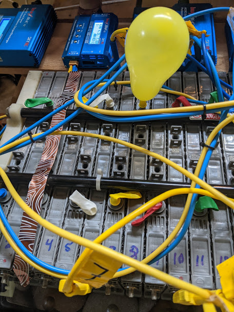

    Not sure how we ended in a Gen 1 battery thread about 12v hacks and talking about HV battery venting? Lol... But the latest pack I'm working on blew up a couple balloons day before yesterday. First one was at the end of it's discharge and inflated in 1/2 second right when my face was over the top of the pack. Second one was towards the end of charging back up from 2volts. Sure am glad I take the time to put these balloons on so my tiny studio apartment doesn't fill with these nasty fumes! Also if anyone knows someone I can mail a balloon to for full chemical analysis, I'd appreciate that data.

    I'm glad you've got a better selection of balloon colors now ... last time this came up they were all pink.
    Also, back then, you seemed sort of sure what they were filling with:
    That was followed by an interesting handful of posts involving sort of point-blank questions about the notion of a nickel metal hydride battery somehow giving off hydrogen sulfide gas (such as, where it would be getting the sulfur?), that did sort of end with the mail-to-a-lab idea:
    Have you had a moment since then to think a little more about the basic question there? Does it still seem like the kind of question you'd need to mail something to a lab before being able to take a stab at?
    Ok, in this thread, the other guy should be posting references and links ... while in the other thread, where somebody did post references and links, you had this to say:
    ... which really does kind of sound (passing over the sneer about presenting references) like you're claiming the level of expertise you would need for telling other people they clearly don't know anything ... about hydrogen sulfide, no less.
    Which makes me that much more interested to learn more about your thinking on the whole NiMH-producing-H₂S business. Surely you don't mean that everybody else's credibility is to be questioned but yours isn't?
