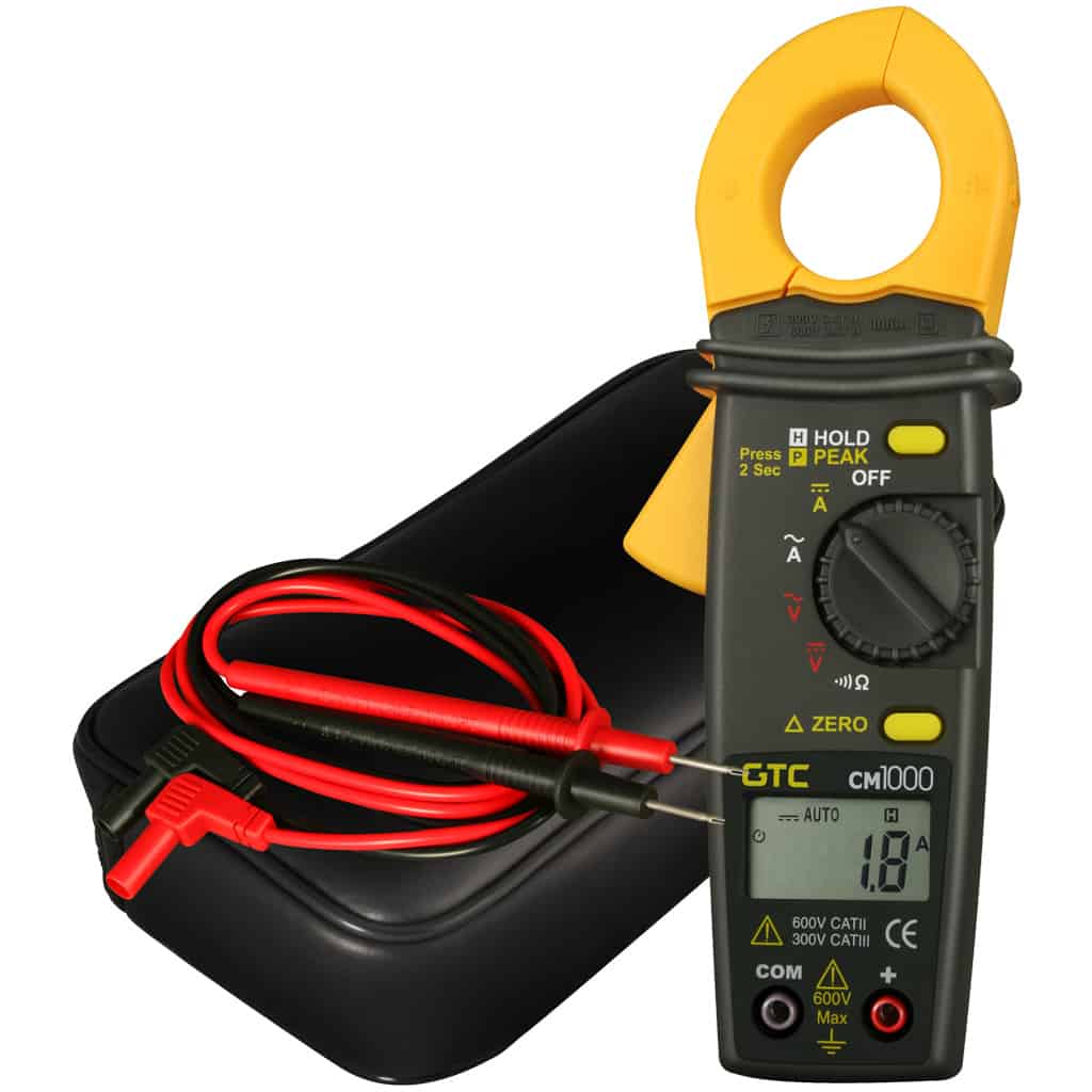

    The CM100 listed above is $170 and claims 0.1% dc ma clamp on accuracies. For most parasitic draw tests you need to reliably read somewhere down to 15 ma dc current.
    Some reviews of the $170 meter say it can do it (comparable low ma clamp-on meters or adapters start at $500) while some reviews say repeatability is bad (meaning one reading one time changes to another the next) and most reviews suggest it is very slow for any basic voltage or ohms reading (3 or 4 seconds) and is polarity sensitive in dc volts (meaning accuracy is poor in dc volts).
    The same can be done with the $5 harbor freight meter (used to be free) when wired in series. Most likely you have a meter that can do the series connected ma test.
    I have a couple of ma dc clamp meters that were highly reviewed but found they were only stable at 100 ma or more. This is fine if the parasitic draw is the "drain the battery overnight" kind but not useful for the 40-90 ma "drain the battery in a couple of days" situation.
    Again the series connection ma technique is accurate and cheap. Given most cars rarely present with chronic parasitic draw (usually a light, aftermarket add-on or an obd2 device draw issue) and most quickly discharging batteries are damaged batteries (easily tested with a load tester) then the series connected, accurate and stable ma testing is the go to for pros and diy as well.
    Measuring parasitic draw accurately does not fix the problem, it just provides a metric to determine if your wiring interventions over the next hour(s) is doing any good.

    You do not need an ammeter to measure the parasitic drain. In fact, you cannot measure the parasitic drain using an ammeter—period.
    Why? Simple: The parasitic drain is not a constant quantity. It will vary throughout the day. Your ammeter would have to have a digital interface with a time-integral-average function. Good luck finding one with that.

    That clamp-on Hall-effect ammeter that measures the current using Ampère's circuital law (the line integral of the magnetic field around a wire is proportional to the current through the wire) is great if you want to look at the charging current etc., but as I explained earlier, it won’t be very helpful in determining the parasitic drain, which is actually not a current but a charge (the time integral of a wildly varying current). Get the cheap BM2 Bluetooth battery monitor, and you will not only find out how much parasitic drain is really there but a lot more like how the battery charges and doesn’t.

    It used to be expensive to buy a clamp ammeter that would measure both AC and DC. That was before this: https://www.aliexpress.com/item/4000575319270.html?src=google&pdp_npi=4%40dis!CAD!70.38!36.18!!!!!%40!10000009741357069!ppc!!!&src=google&albch=shopping&acnt=631-313-3945&isdl=y&slnk=&plac=&mtctp=&albbt=Google_7_shopping&aff_platform=google&aff_short_key=UneMJZVf&gclsrc=aw.ds&&albagn=888888&&ds_e_adid=&ds_e_matchtype=&ds_e_device=c&ds_e_network=x&ds_e_product_group_id=&ds_e_product_id=en4000575319270&ds_e_product_merchant_id=108355505&ds_e_product_country=CA&ds_e_product_language=en&ds_e_product_channel=online&ds_e_product_store_id=&ds_url_v=2&albcp=19366866438&albag=&isSmbAutoCall=false&needSmbHouyi=false&gad_source=1&gclid=Cj0KCQiAy8K8BhCZARIsAKJ8sfRj7EOU9E0HEobjri0OSlPsyAwFVE1H8o0A_pZSm2TabC0JYZN78LcaAr9xEALw_wcB
    I've had one for a few years, and I find it to be quite accurate.
