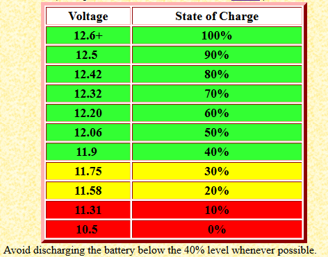

    Not sure of the source of this:
    but it is not really a good chart for AGM batteries (normal flooded Pb/A,yes) as used in our Prii, as its voltages are too low for AGM. If you are going to continually post a chart, please update to data suitable for the AGM batteries used in the Prius.
    Here is a better chart:
    Pb:A voltage band (SoC).jpg
    A fully charge AGM battery will be in the region of 12.9-13.2 V and at 11.7 V is considered fully discharged. Interestingly there will be no adverse symptoms in the Prius until the voltage drops below 10.5 V (on start up) which may only occur briefly and would not normally be seen unless a DVM is connected and observed at start up. In the chart above the top line of the envelope is closer to AGM and more modern "maintenance free" batteries (with, e. g., calcium additives) which typically have a higher voltage when compared to regular flooded Pb/A alternatives. These regular batteries typically follow the lower line.
    Having said that, the importance of keeping a Pb/A battery at the full end of the spectrum cannot be emphasised enough. A discharged (or semi-discharged) Pb/A battery suffers damage the longer is stays discharged (or semi-discharged) and therefore affects the longevity of the battery's useful life. If you are happy to replace your battery every 3-5 years, don't worry about any of this, but if you think you should get 10-15 years of life out of a battery, then get a battery charger and use it often.

    Well that's a massive information dump.
    The car has been sitting outside for at least 12 hours now. And I checked again the car in ACC mode.
    I looked at that chart, looked at the voltage, and see now that my battery is at or around the 50 percent ish. Dead mark. The other person's image seems to say mine is around the 70% mark so I'll take your word for it as you seem to know what your talking about.
    For now I know that I have time to start looking for a new battery, thanks!

  20. exstudent
    exstudent Senior Member
    Jul 11, 2009
    2,214
    906
    Torrance, CA
    Replace the 12V battery with a good AGM battery and be done. The current battery has suffered a massive MI (myocardial infarction). Its life expectancy has been cut considerably and is no longer reliable.
    Price shop a replacement from your local Toyota dealers. Or just go to a PepBoys near you and get the Bosch NOT an Optima.
    Bosch) 46Amp Hr (same rating as Toyota batteries for SKS Prius), $143, 4year warranty duration (no proration).
    Optima) 38Amp Hr, $238, 3year warranty.
    Bosch Premium Performance Battery Group, Size 51 | 647478 | Pep Boys
    Read post#5 to learn how to put a larger load on the 12V battery for a better reading. ACC is too light of a load.
    Read post#8 to see an AGM battery chart breakdown and some current smart, AGM compatible 12V battery chargers.
