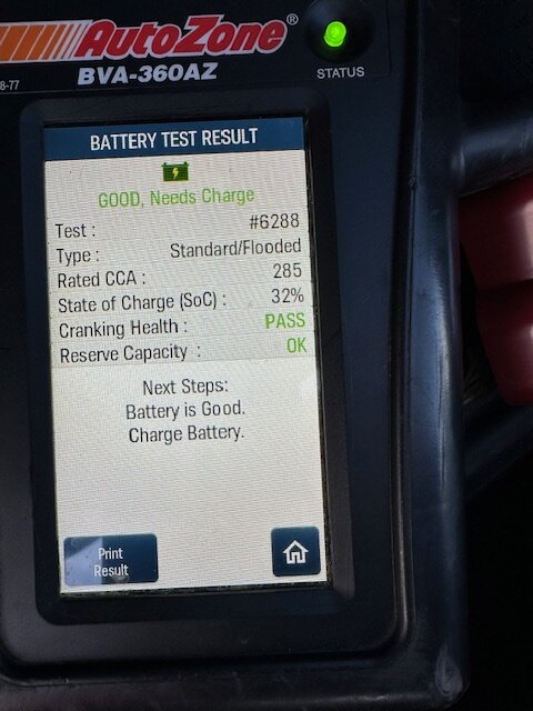

    @bisco thanks. You're right. When I pulled into Auto Zone today, an employee had just finished checking someone's battery. He then helped me. Walking in, I saw a different employee checking someone else's car. lol. It's battery day at Auto Zone.
    I had intended to buy the Noco Genius 1 there, but the website was wrong (they didn't have one in stock) so I've ordered that and the Solar BA9 charger from Amazon and will get them tomorrow. I'm curious now. The Auto Zone battery tester didn't show CCA but said my charge is now 32%. I didn't drive at all last week. My normal driving is not helping (mostly short trips around town) but I'm surprised this is even lower than the 61% charge and 73 CCA when the car sat for 6 weeks. (the AAA display, photo above. BTW, the AAA guy did not connect to the battery directly but under the hood. And his display shows the battery specs at 350 CCA, not 285 CCA).
    I had a 2006 Prius (and other cars) and never had this problem, so this is frustrating. Is there a definitive list of things to be mindful of related to the parasitic drain? I read some of long chat thread, which is a discussion (key fob bad or not?), but I'm wondering if someone compiled a definite list. thanks

    This is why I don't like these newer algorithmic battery scanners. I consider them random number generators, made for gen-z that can't use their brain.
    The AAA test was OFF because it had the wrong CCA, so it showed only 73 CCA available. Don't know why a battery with only 73 CCA would be considered a passing grade. That would barely start a small engine on a 30F day. If it was a 6 or 8 cylinder, you would be walking.
    That Autozone tester seems to be a bit better, but not knowing it's internal algorithm - I can't really say how accurate it really is.
    I'm a bit old fashion and prefer the brute force approach of a carbon pile resistance battery tester. The battery must be fully charged (SOC) in order to pass that test and since it's an analog display needle, you can make your own judgement - If it's good enough.

    Idk what 32% charge means. It seems awfully low. I thought they would do a voltage reading as well.
    I think you might need a charger as well, but I’m no expert

    1) 2pm first check, the 12V charge is 0, CCA 229 (Thurs @ 4pm AutoZone tester show SoC 32% and CCA "passed", whatever that means)

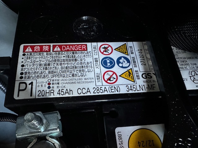

    According to my CTEK charger, choosing regular vs AGM mode simply bumps the charging voltage, with the AGM. Also, it recommends to only that only with "spiral wound" style AGM (the ones that look like canned beer 6-packs). So, I'd say no harm, just using regular mode, at most it might not charge quite as fully.
    Googling, AI says the gen 2 OEM battery is rated 325 CCA. That sounds right, and it is the case for gen 3 as well. The "RATED: 285 CCA" on your TopDon's display, did you enter it (say based on a label on the battery), or did the scanner come up with that. At any rate: the as-tested CCA it's display don't look good. A typical battery in good health will in my experience display higher than spec'd CCA, which I'd suspect is aforementioned 325. In your shoes, I'd be replacing it.
    "CHARGE= 0% 11.94V" I would gather is the voltage it measured is 11.94, and it's really in need of charging. When the Solar BA9 arrives I think you'll find it simpler but more to the point: it'll display as-tested CCA and VOLTS, toggling between the two, and give a verdict: pass, pass-but-charge, and fail (words to that effect).

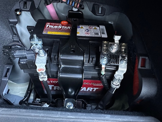

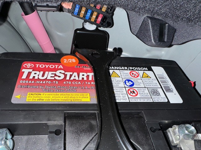

    Hi everyone, I got a new battery from the dealer (under warranty) and it’s even an upgraded one. Thank you!!!!
    When I met with the service advisor, I showed him the photos from the AutoZone and Topdon testers. He was skeptical about the accuracy of these devices (their tester costs thousands of $$$), but professional. He admitted the numbers looked off, especially that the CCA and SoC were moving in opposite directions. He also said that since the AAA guy had entered the wrong CCA (back in Nov), those results were meaningless. (doesn’t matter now, the dealer charged it back in Nov)
    Anyway, yesterday the battery failed their load test. The service advisor’s opinion is that the Nov failure was due to it sitting for 6 weeks and only driven once, briefly. But he said this current issue showed a defective battery. It happens.
    Going forward, his opinion is that I don’t need to worry about using a charger or tester—just drive continuously ½ hr once a week. (a couple short trips with stopping won’t work, since starting the car draws so much from the battery). If I take a 3-week vacation, say, have someone drive it ½ hr mid-trip.
    It was a slow day (who takes their car in on Superbowl Sunday?) so I talked to the parts guys about testers and chargers. Again, they can’t comment on these low-cost testers. He also thought I should just drive it, but said if I was really worried, a battery maintainer could be a good idea and just leave it on all the time. That’s what he does with the motorcycle he rarely drives. He thinks the NOCO 10 might be overkill for just maintaining a battery but admitted he uses a 10 amp one on his motorcycle.
    Parasitic draw: his opinion is that you can’t really reduce the background draw. Using a faraday box/bag won’t help. Even if the key is out of range, the car will still send a signal looking for it. Same with the phone apps. Even if I delete the app, the car will still be signaling. Not sure if this is true that you can't reduce the draw, but FYI. He did said people on these chat boards sometimes know more than they do. Lol.
    The bonus that I discovered is that the new battery is 470 CCA. When I pointed this out to the parts guy he said it was an upgraded battery and that is has more “dead range.” (after it’s “dead,” there’s more a buffer of charge?). It’s also AGM, though it’s not labeled, but he showed me the breather on the left side.
    So this current issue is put to rest – thank you! I’m going to consider whether the keep a tester and charger, or just be mindful about driving it, but I have a few weeks before I need to return anything. (the Solar BA9 tester arrived last night, after I picked up the car from the dealer.) Thanks again for your help! (and if you have other thoughts, let me know) Thank you all!!!!

    Thanks @Mendel Leisk . With my 2025, the battery is easy to access on the right side of the hatch compartment, so I considered a "permanent" connection to the battery with just the half of the cable that does not plug into the wall. (right side, in diagram below). The NOCO 1 cable disconnects into two parts, and the clamps have "integrated eyelet hooks" that can be attached to the bolts. The parts guy was showing me where but unfortunately with this new battery, the positive plug/bolt is under a protective covering, which makes it trickier to access. But is this a similar idea?
    So I could disconnect the clamps, leave the part (on the right hand side, below) connected and in the trunk and then just connect and plug in when needed? Is that what you're thinking?
