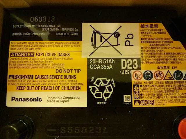

    My dealer has a 28800-31290 on hand, so I took a photo and confirmed it is the updated Panasonic S55D23L, now with capacity marked on the label--and it seems to have grown three more amp-hours in capacity since mlibanio found the 48 Ah figure on an old datasheet.
    At 51 Ah this might be the highest capacity of the batteries usually discussed for the Gen 1 (for example, the often-mentioned Optima yellow top seems to be 38 Ah; this beats it by 34 percent). With the price increase it now also costs more than the yellow top, so it's no longer quite the unsung bargain it used to be. Still it's a very good battery, and if your car ever had the service bulletin EL014-03 performed in the past, this is the battery that will drop in and perfectly fit.
    I guess I'm not sure how to read Panasonic's date codes. I assumed the 120406 on the one in my car meant it was from late 2006, but the 060313 on this one doesn't really make sense that way. (If you're reading this post after June 3rd you might think it makes sense, but the dealer told me it arrived in April so the date of manufacture can't be later than that.) Anybody know the official right way to read these codes?
    -Chap

    DDMMYY
    So 060313 would be March 6, 2013
  14. ChapmanF
    28,720
    19,019
    Ok, now I feel a little dopey for not having thought of that, but it makes perfect sense. (My consolation is the guy at the dealer parts counter didn't think of that either.)
    Thanks!
