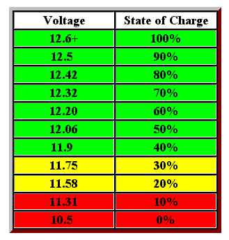

    Because the battery is pushing 7 years old but according to the following chart it is 90% charged at rest, which isn't too bad as you say. Maybe I'll keep it another year.

    That chart is for a flooded lead-acid 12V battery. AGM at 100% charge is 12.9V, by the way.
