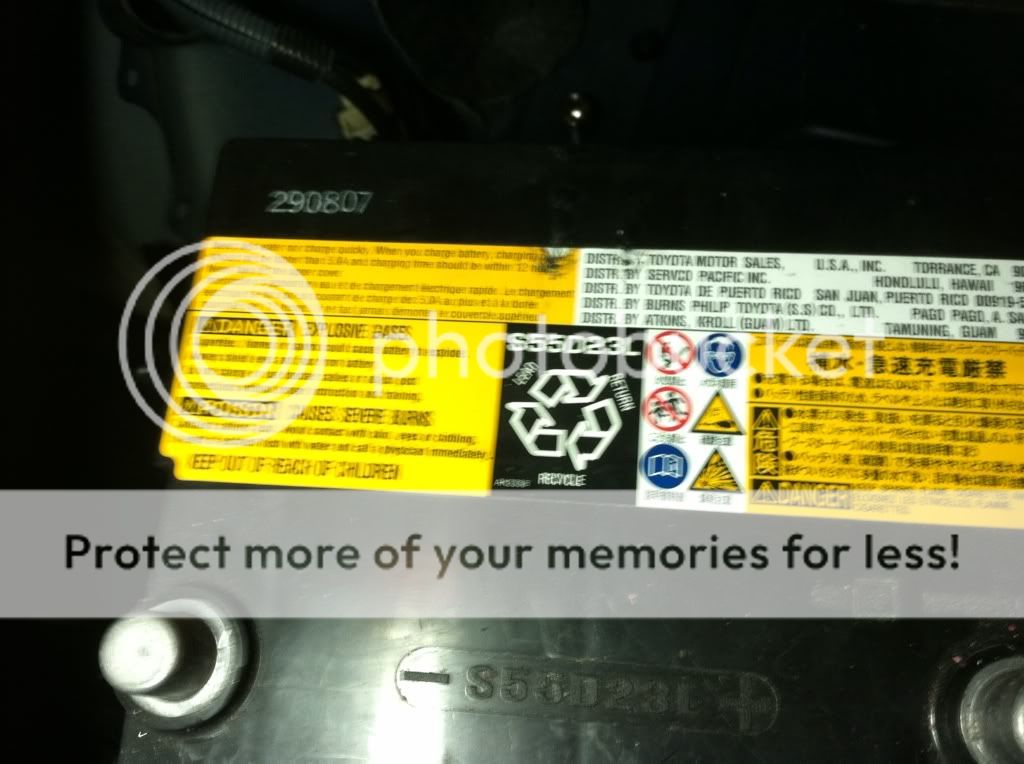

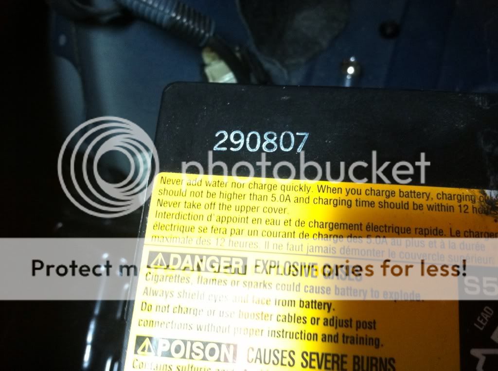

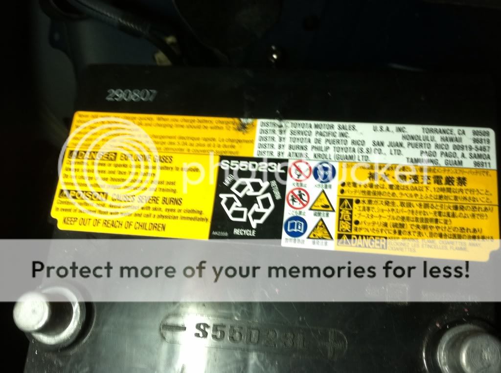

    I was checking my 12v battery for a date to see if it needed to be changed while I still have funds to do so. I bought the 2002 from a really small dealership.
    I have pulled the battery out searching for a date and there isn't one. Unless there is some kind of a code on it. I took pics and will post them as well. If I go to the local dealership, will they be able to tell me if any of the dealerships have installed a battery? Would they charge me anything to tell me the info?

    290807 = 29th Aug 2007
    Outside of the US, much of the world uses dd-mm-yy for date codes.

    Nope. 290807 is the code for ethylhexyl methacrylate.
    Its on alot of batteries.

    Thanks for the info Ed. Now that I think about it, my date code wasn't stamped directly onto the battery like that. Mine was in the same format (261104 = 26 Nov 2004 in my case) but it was on a separate little white rectangular sticker that was attached to the top of the battery. It looks like in the OPs case someone has removed that sticker.

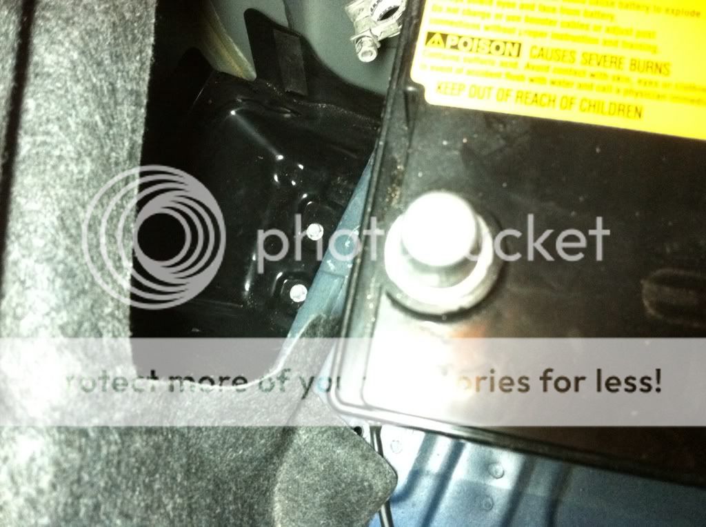

    Well, What should I do? I included pictures of the posts to show how clean they were. I don't know, maybe the 1 man team cleaned the battery posts up to make i look better? I don't know... Should I test it periodically to see if it is losing its charge etc? Would my local Toyota dealership be able to run the VIN and find out if and when it has been replaced?

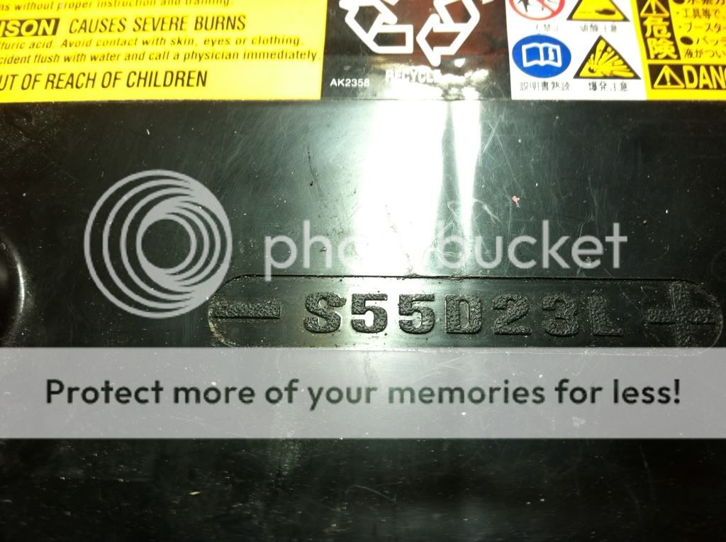

    Here's what I would do:
    Keep the battery. What you have is a replacement battery installed sometime after the TSB (or recall) came out to replace the original 12V "GS" battery (identified by big "GS" letters on the front). It (the Panasonic you have) was an upgrade to the original battery. My experience with the lesser GS battery was a 10+ year service life. When I finally replaced it, I did so not because it was causing problems but just for good measure. I still have the battery and I am confident I could charge it, reinstall it and use it for who knows how much longer. The 12V battery is only used to boot up the computers and run some aux functions once the car is in ready. It gets charged by the traction battery through a dc-dc converter. If it does go bad, you will see some crazy things happen in the electrical/electronic system that are unexplainable (ie: check engine lights that come up for no reason or other warnings). The strain or demand on the 12V is minimal which normally results in longer life.
