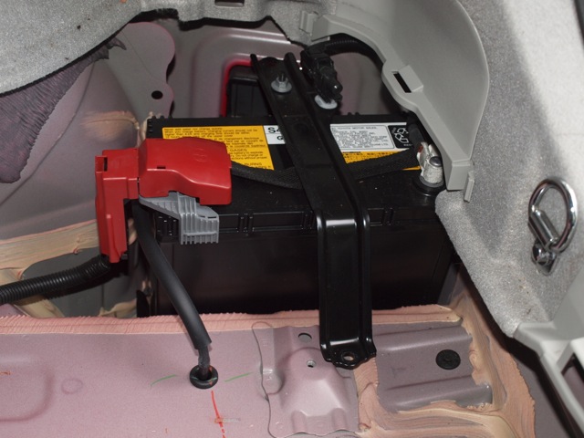

    Found the pic below in another post. So where do I connect the negative from the BatteryMinder? Is it okay to connect it to that metal ring outside the battery area? Or is that metal on the far side towards the left that it can be connected to, the thing that has the hole in it? Not sure what you meant by "switch". Then I guess I have to open the hatch from inside (don't know where latch is inside)? Or I guess I can get the battery back in from inside the car.
    Okay, now I found a pdf saying that the battery should be removed from the car to charge it. I attached it. I don't know what to do... I don't need the extension if I do that though, and if I'm going to disconnect it I might as well pull it out, right? If I do pull it out then do I attach both positive and negative to the battery terminals or do I still only attach the positive and ground the negative on something metal?

    Once you disconnect one of the battery cables (we are suggesting the negative cable to the car body as it is the easy one), connecting the charger is safe. One of your earlier questions stated a concern about out-gassing under charge, but the Battery Minder only does a slow charge so should not cause out-gassing and your battery is "Vented" (a vent tube from a pressure relief valve in the battery leads outside the car).
    The switch that I mentioned earlier would be a new component that you install in the negative connection to the car body for convenience. It would, along with the quick disconnect cable at Amazon, make connecting your Battery Minder easy to do.
    One last point. If you close the hatch with the battery disconnected, you will have difficulty reopening it. The hatch release is a 12v device. There is a manual release (crawl in through the rear seats), but that is a pain unless you are small. So don't close the hatch while 12v is disconnected.

    The Hella looks like a good one, but you will have to drill a mounting hole in the hatch space for it.
    You will see where the negative cable attaches to the body when you take out the hatch cover and tool bin.
