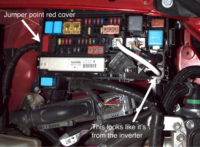

    Instead I used an linear DC power supply, with the voltage set at 13, and the current maxed at 5A, connected to the "jump" terminals on the Prius.

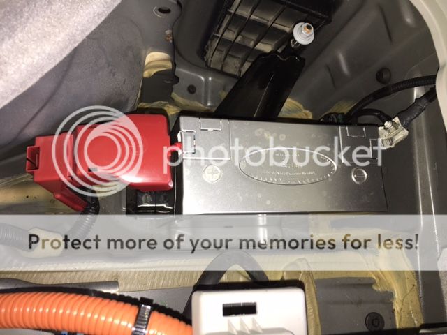

    Keeping the linear power supply attached to the jump terminal on the Prius (to preserve settings, trip meter, etc), I removed the nearly dead 12v battery and replaced it with the LiFePO (lithium iron phosphate). It's rated at 20 aH, which I believe is roughtly half the capacity of the OEM. Even though it's half the capacity, LiFePO4 batteries can be discharged to roughly 30% remaining capacity without causing damage, while the OEM lead-acid battery would be damaged by that deep of a discharge.
    So far the LiFePO4 battery is performing just fine, and as a bonus, it's 22 lbs lighter than the original (OEM = 29 lbs, LiFEPO4 = 6.6 lbs). Venting is not required for this chemistry.
    I used a wooden block to act as a spacer since the battery is physically smaller than the original. This allowed me to use the retention bracket that held the OEM battery in place. I also had to fabricate short lead wires to adapt the power cables from the car to the terminals on the battery. Here I just used 10 AWG wire and soldered ring terminals.
