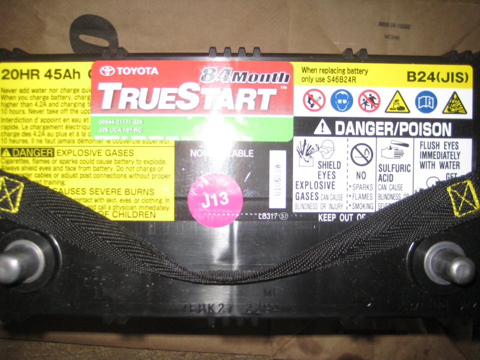

    What Patrick said is the answer. Go to the dealer and get the alternative battery tray. Two trays are made for the Prius. The NON Smart Key Prius uses the smaller battery and the small tray. The battery you bought requires the larger tray. The hold down clamp is the same on both models. Only the tray changes. Easy fix, but you will have to pull the battery to change the tray.
    FWIW, I think the TRUESTART battery found at Toyota is better than the Optima yellowtop. But that is just my opinion. It is based on numerous reports of recent yellow tops failing quickly and having very short life spans. You can find this information here on Prius Chat if you search using Google.

    I agree, and one other thing, the OEM battery is rated at 45 Ah where as the Optima is rated at 39 Ah. If you don't want to go OEM, there are better batteries than the Optima.
    This info is more for the people that come along later, not really of use to zellum as it is a fait accompli for them.
    dorunron likes this.
  17. dorunron
    dorunron Senior Member
    Jul 17, 2011
    3,318
    1,105
    Houston, TX
    45 Amp/Hr it is. Plainly shows it in the photo above. And yes, the yellowtop documentation from the factory plainly states 39 Amp/Hr.
    6 Amp/Hr does not seem like much, but these batteries are small to begin with. Why cut your throat even worse by buying a battery with less power to spare?
