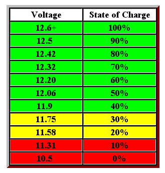

    Yeah maybe I'm over-reacting. An electronic load test would clear up the mystery. If done by pros, I'd maybe go to a battery retailers to get such a test, say Pep Boys for example. They usually do them for free, hoping to sell you a battery. It'd be interesting to see the outcome of such a test. 12.25 volts seems really low to me though, especially for a brand new car.

    Update - I tried a second voltage meter and it read the same voltage as the first. I took the car by my local dealer hoping they’d be able to do a quick battery evaluation - no way....dealer was a madhouse. Service writer said they’d need it for “at least half the day”. I then thought I may as well try the local pep boys (thanks Mendel). Pep boys hooked my 12v up to their machine and the results indicate it’s fine.
    READINGS:
    Rated at: 295 CCA
    Measured: 463 CCA
    Measured voltage: 12.66v
    State of health: 100%
    State of charge: 80%
    I’m still a bit confused as to why the state of charge is below 100% ...... but the tech at pep boys didn’t seem concerned. Based on his test, he thinks the 12v “is absolutely fine”.
    Thanks to everyone for their input and advice. Rosencrantz

    Good idea. I may try this. When I was at the madhouse dealer this morning, the service writer seemed to think that anything above 12v was good .... that was the acceptable number from from that Weber U video too. Is it possible that the car was engineered to charge the 12v battery to around 75-80% ? I’d be curious to know what the overnight resting voltage might be on another gen4

    a new battery will measure 13+ volts when fully charged. how long it will hold there, idk. you need to get a voltage to the computers that is within their operating parameters.
    many factors go into that, and no one can say what battery voltage under load will suffice, without all the information.
