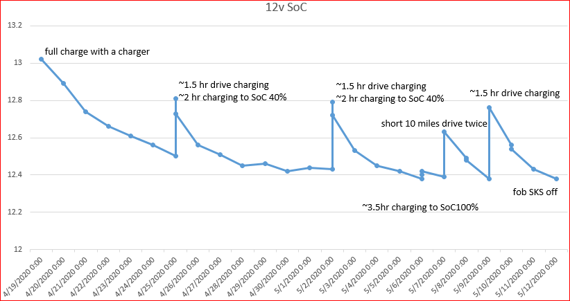

    Here is more detailed data and a summary of my previous PP (2020) when the car was less than 2 mo old. But the car was kept parked more often than driven. On average it was driven only once a week. It is clear that PP has some "normal" drain when parked. The 12v battery in PP almost always drops down SOC (resting volt) daily.
    If anyone cares to read the discussion, here is the link to the thread that dives much deeper into this subject.
    12v Battery Is Discharging, Re-Charge Now ! | Page 11 | PriusChat
    Some observations with 2020 PRIME LE, driven once a week (plus additional short drives in 3rd week).
    • using an external charger brings the 12v battery SoC higher (~13v) than using an on-board internal charging system (12.7v-12.8v)
    • max SoC by on-board internal charging system decreases slightly each week (12.81v, 12.79v, 12.76v)
    • first 24-48 hours 12v battery drains most at ~0.1v/day and less drain/day subsequent days
    • ~1.5hr once a week drive is sufficient to keep the 12v battery SoC to stabilize around 12.4v after 5 days
    • short 10 miles drive is insufficient to bring the 12v battery SoC 100% (12.7v)
    • ~3.5hr L1 charging had almost no effect in replenishing 12v battery SoC (from 12.38v to 12.42v)
    • turning SKS OFF from the fob had no effect on the 12v battery drain
    #31 Salamander_King, Oct 2, 2022
    E-GINO and Gokhan like this.

    Well, I did not say SKS uses no power, I just said “turning SKS OFF from the fob had no effect on the 12v battery drain”. The drain was not stopped and the rate of the drop was not appreciably slowed by turning off the SKS, thus the conclusion is that the power used by SKS is not the only factor causing the 12 v battery drain. Or at least it is not the major power drain source. It could well be a small part of the whole normal drain on the 12v battery, but by itself, there is not a huge draw.
