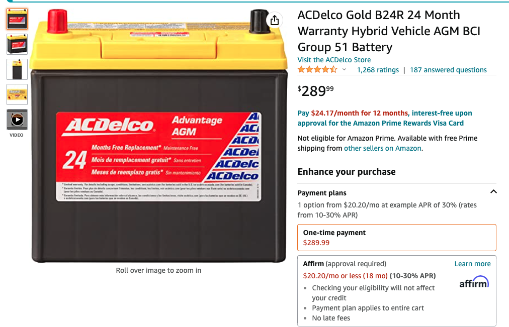

    I bought this battery from Amazon 2 years ago for $140 delivered (Prime Member).
    Its absolutely crazy what it costs today.
