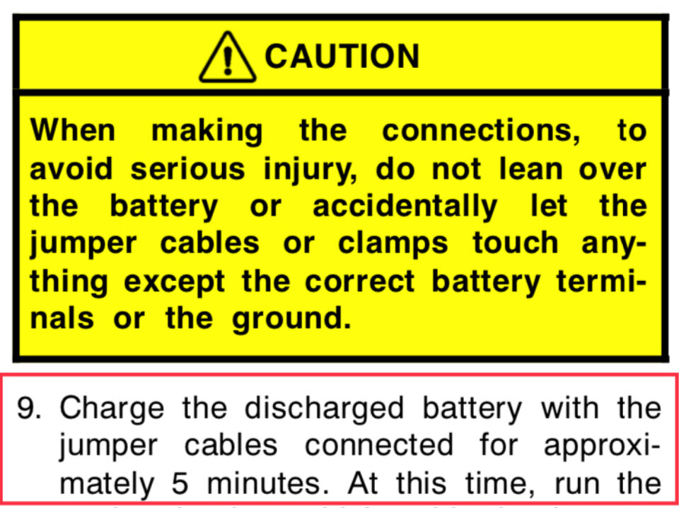

    "Possible" if you left it connected for 5 minutes before trying to Ready it.
    A better plan is a lithium jump box in the cabin accessible without opening the hatch and practice hooking it up under the hood.
    Often Good Samaritans and tow truck drivers don't know how without direct access to the 12v battery.
