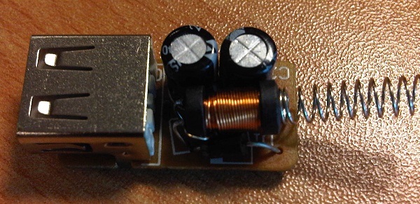

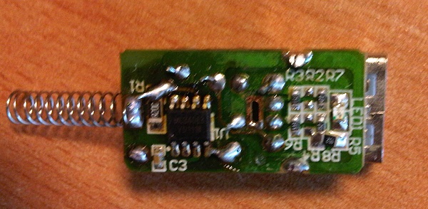

    The typical construction is a step-down DC/DC converter with output current limitation. It is today's most effective way, which didn't produce to much heat.
    I disassembled the lighter socket USB charger as shown below. It is 1A vesion, where USB pins 2-3 are shorted to instruct the connected device to use full charge current.
