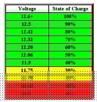

    This chart is for flooded lead-acid batteries. Add 0.3V to the values for AGM.

    Patrick,
    Thanks for the heads up. What is your opinion of the chart in the attached pdf file? Is there a better source of a voltage chart for AGM for reference?
