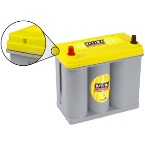

    The battery doesn't have the vent as shown in the pic?

    Thanks. Yes I went to optima-and found that picture a few minutes ago-went out-pulled the little L-Tube nipple off the old battery-plugged it in the optima
    Yes it has that recessed opening.
    Two questions-does the Optima not come with a nipple? I was looking for a nipple-just like the old battery-none in box none on battery?
    Any chance that opening has a recessed plug? Meaning I have just jammed it into the battery-and have been running with an unvented battery?
    I put the nipple in with the battery in place-tricky-so I couldn't actually see any plug?
    Guessing there would be a warning on it if it did-but it didn't come with ANY instructions?

    Usually any replacement batteries don't come with the little elbow for the vent, you have to use the old one.

    congrats, sounds like you have the right battery and got the vent tube hooked up.
