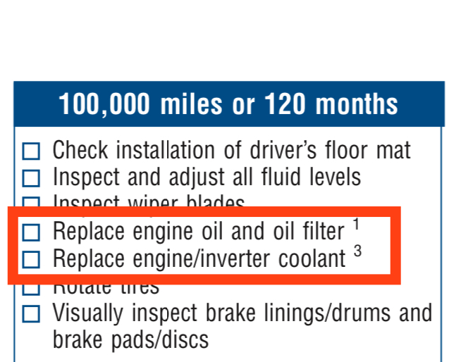

    The "3" footnote in the above, points to this, a couple of pages forward:
    Also, you might have this sticker on the side of the inverter coolant reservoir:
    FWIW, the above pic is even on my Canadiant spec 2010. That said, Toyota Canada recommends to change both engine and inverter coolant, at (roughly) 100k miles or 10 years, whichever comes first.

    I spoke with hybrid fix in LA they recommended based on footnote in Toyotas manual to do those at 150k not 130k. Does that resonate with you ?
  18. bisco
    115,480
    52,863
    with the head gasket concerns, i'd do the coolant now and more often than the recommendation. just to be on the safe side.
    or at least test the ph
  19. Mendel Leisk
    61,562
    42,355
    One of the elephants in my room: there's both a month and miles component to this, whichever comes first. The other, that Toyota Canada says to do both at the earlier interval. I even emailed them about the sticker; they said to ignore it. Anyway, at the 120 month mark (aka 10 years) I dutifully changed both. The odo was at 88k, kms. About 55k miles. The drained stuff looked pretty good. I'll do it again at year 15 I think.
