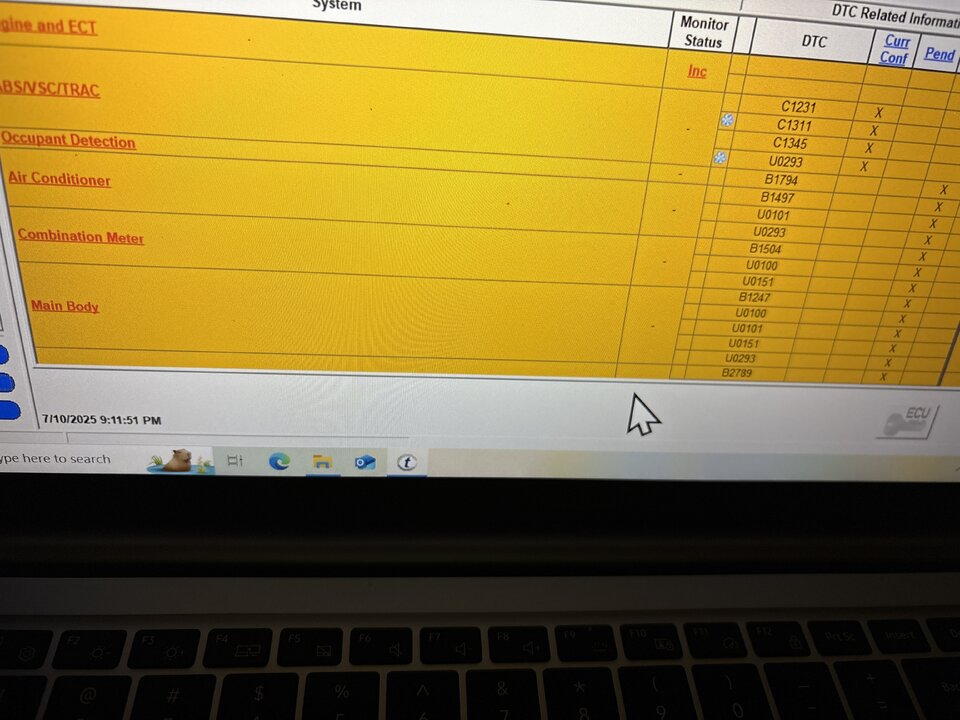

    Also C1231 steering angle sensor circuit
    C1311 open circuit in main relay 1
    C1345 Linear solenoid valve offset learning undone
    U0293 lost communication with hybrid vehicle control/ev control system.
    going to recharge 12v aux battery overnight.
    Jack

  4. Adventurer2112
    Adventurer2112 Junior Member
    Aug 31, 2019
    55
    21
    Urbana
    2014 Prius c
    Hi Brian,
    That’s where I’m
    Getting these DTC.

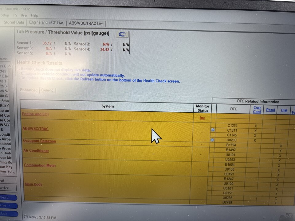

  5. Adventurer2112
    Aug 31, 2019
    55
    21
    Urbana
    2014 Prius c
    Posted

  6. Brian1954
    Brian1954 Senior Member
    Jan 31, 2021
    2,688
    1,074
    South Central PA, USA
    You need to be concerned with the four current trouble codes that you listed in post #3. You do not need to worry about any of the history trouble codes.
    Charge the 12v battery tonight and run a new Health Check tomorrow. Include another picture showing the trouble codes (take a picture that shows the complete computer screen).

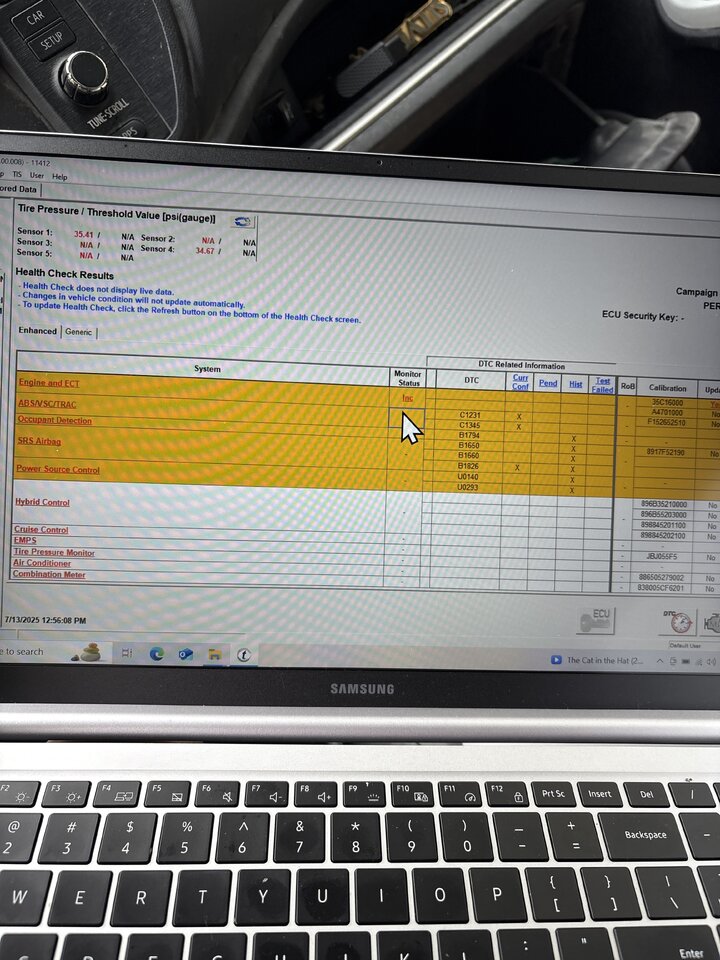

  8. Adventurer2112
    Aug 31, 2019
    55
    21
    Urbana
    2014 Prius c
    Hi All,
    Current conditions see. I don’t know how to clear them.

  13. Adventurer2112
    Aug 31, 2019
    55
    21
    Urbana
    2014 Prius c
    Hi All,
    Reading all data. Going to attempt
    Linear solenoid valve init. & calibration to clear the code.
