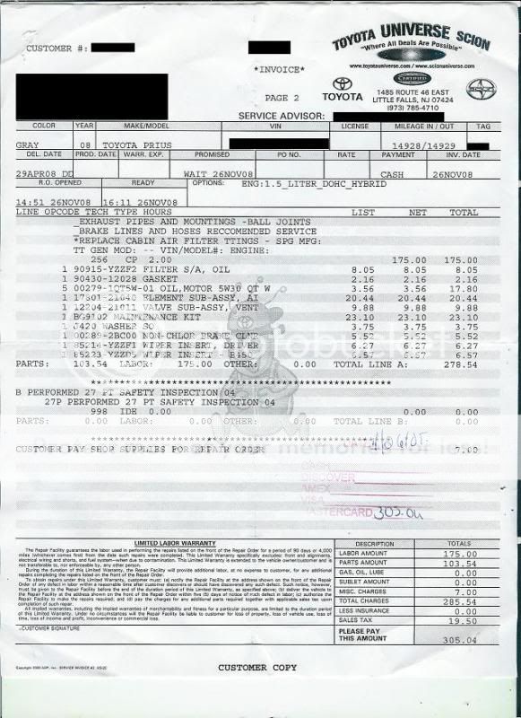

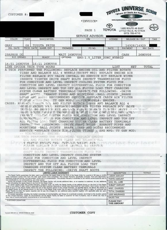

  11. neon tetra
    neon tetra Member
    Apr 9, 2008
    309
    I attached the paperwork they gave me.
    I think I'm just trying to figure out what makes this "special" service so much more expensive than the $25 regular oil change or the ~$60 5000 & 10000 services.
    (they're hard to read until you make them full-size)
    Is there anything in there that's a blatant rip-off/scam?

    Phoenix, AZ
    Ouch. The bogus items are balance tires (should last the life of the tires unless you lose a weight), engine air filter (30K recommended, not 15K), cabin air filter (ditto), tighten driveshaft bolts (huh?), inspect transmission fluid (only necessary if it's leaking; I'm 99% sure they didn't even remove the plug), clean battery terminals (only if they're dirty, unlikely after 15K), load test charging system (the Prius can self-test its own charging system, no need if there's no "check engine" light), "BG service kit" part BG9102. This isn't a standard Toyota part, it's a fuel injector cleaner, totally unnecessary after 15K. The PCV valve should last much longer too.
    Depending on the condition of the wipers, they might have needed changing.

    Green Valley, AZ
    - I agree the PCV valve should last at least 60K miles; this one item may be responsible for $100 of the overcharge (when considering labor involved to replace)
    - You should have been charged for 4 qt of engine oil, not 5 qt. Also the price is pretty high for bulk oil. Have you checked the engine oil level on the dipstick to see whether the engine oil was overfilled?
    - The "load test" of the "charging system" sounds bogus, no need for that.
    - Note that transmission fluid and differential fluid inspections are itemized separately; of course with Prius both are the same fluid.
    - Although it is true that the prescribed service interval for the engine and cabin air filters is 30K miles I have found that 15K miles is reasonable in an urban environment. When you hold up the used engine air filter to the sun you should be able to see light passing through. If not it is time to replace the filter. Regarding the cabin air filter since you have to breathe through it you may (or may not) want to replace it when it gets nasty, which may be sooner than 30K miles depending upon where you park, etc.

    I noticed that they charged you list price for all the parts - so they made a big profit just on those. For example, they charged $8.05 for the oil filter. My local dealer usually has them on sale for about $5, and I bought 10 for $3.99 each w/ free shipping from Toyota of Dallas. Similarly for the gasket; $2.16 vs. $.80.
