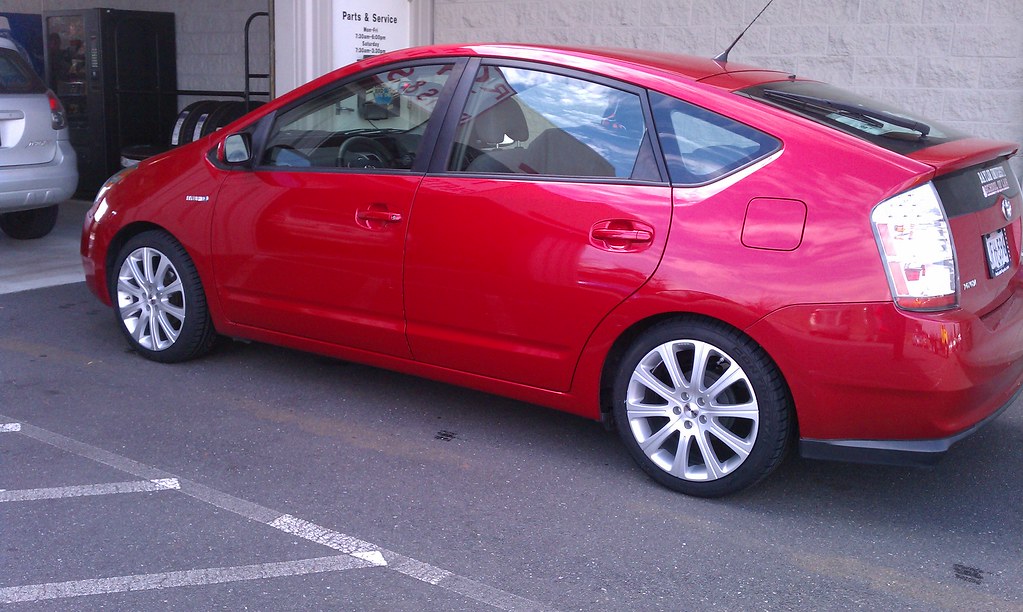

    Congrats!
    It handles sooo much better doesn't it?
  12. acheslow
    acheslow New Member
    Apr 21, 2007
    16
    Bothell, WA
    So far I haven't noticed a huge difference in regular driving, but I definitely have much more control when turning at high speed and when accelerating hard from a stop. I have much more confidence when driving for fun.
    Also noticeably quieter.
    We haven't had any rain yet this week in Seattle, but I expect it will handle wet roads better too.
    Thanks!
    Alan
  13. F8L
    Aug 14, 2006
    19,011
    4,083
    Grass Valley, CA.
    Just wait until you start taking it through the twisties. It'll stick much better. Looks good too. :)
